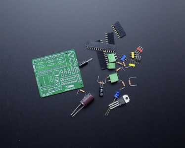

Step 4: Printed Circuit Board
A printed circuit board (PCB) was designed to integrate all components, including the DFPlayer, PIR sensor, servo motors, speaker, and Arduino Nano. The goal is to create a more stable circuit and prototype.
  1. Arduino Nano (main controller)
  2. DFPlayer MP3 module (for sound)
  3. PIR sensor (motion detection)
  4. 5x servo motor inputs
  5. Speaker for audio output
PCBWay was chosen for the PCB fabrication. You can find the Gerber file and circuit diagram for PCB fabrication at this link: https://www.pcbway.com/project/shareproject/The_Face_maker101_c4124445.html Also, if you have no soldering experience, you can use PCBWay's assembled PCB service.
I also participated in PCBWay's 7th design contest, if you want to support the project, you can vote for the project from the same link. Thank you.
The component list includes capacitors for power requirements, resistors for servo motor digital inputs, terminal blocks for the sensor and speaker, and female and male headers for the DFPlayer and Arduino Nano.
  1. Resistors and capacitors (for power regulation)
  2. Terminal blocks (for the sensor and speaker connections)
  3. Male/female headers (for the DFPlayer, Nano, and servos)
I soldered all the components in place using a soldering iron and solder wire. This setup ensures that the entire project runs smoothly and that the wiring doesn’t get messy.
