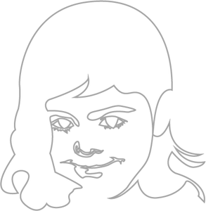

Step 3: Portrait Prep
Keeping the drawings simple here to reduce too much busy-ness in the text later on. This can be done by drawing directly over the photos or as an interpretation. I worked in Adobe Illustrator.
Step 4: Text Turns to Image to Path to Print
  • Convert the text to a shape. Object, Shape, Convert to shape. Turning the text into a shape will create an editable vector and keep the image quality.
  • Overlay the portraits on top of the appropriate text, and experiment where the paths of the images look best over the text shape being mindful of where the black/white will lay when printed. This is very much a puzzle piecing exercise.
  • Some paths in the portrait will be lost entirely. Experiment with hiding paths in the layers panel (I ended up erasing entire head shapes) to better suit the final text image. Also, erase parts of the text that overlap so the vinyl in that area won't cut twice.
