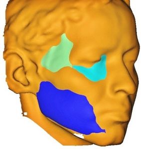

Step 4: Step 3. Quantification of Defect by Using MIMICS ( Materialise NV, Belgium )
a. Import repaired .stl file in MIMICS software.(figure 7)
b. Divide the 3D object into two halves along the mid sagittal plane using cut with polyplane option. Split the object into two largest parts.(figure 8)
c. Mirror the left half face and superimpose on right half .(figure 9)
d. We find the multiple region where defect is anticipated.
e. Boolean subtraction operation is performed by subtracting original right half from the mirrored image. (figure 10)
f. The region of the defect are thus revealed. The subtracted object is than split into small parts. The significant large parts are retained and quantified. (figure 11 and 12) The volume of the defect can be known in the properties option of the object. This volume corresponds with the amount of fat required.
g. These defect object files are exported as *.stl file for 3D printing.(figure 13)
h. These 3D printed guides (figure 14) were used as guide to mark the areas requiring fat grafting.
i. Also made 3D printed whole face model for exact simulation of case for teaching and discussion purposes (figure 15A,B,C and D)
