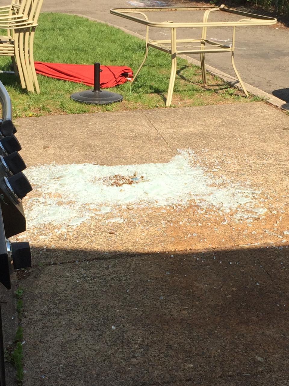

We had very strong winds one day and the top for our patio table shattered. I looked around for options to replace the top, but a custom piece of tempered glass is very expensive and I can't remember who made this table. Most of the sites I found said a manufacturer replacement top would still cost close to $200. I could buy a new table for that much, but the rest of the set is still in good shape. I decided to try to make a new top myself.

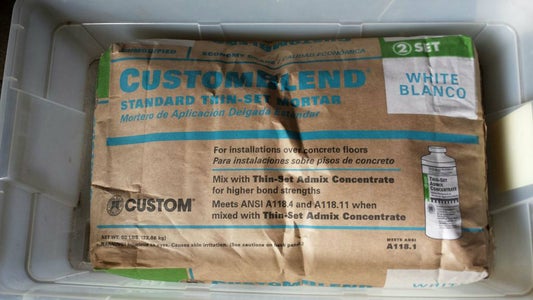

I bought a big bag of dry thinset mortar. If you mix it yourself, it is much cheaper and you can use as much or as little as you need. After I finished tiling the table, I had more than half a bag of mortar leftover for the next project or future repairs.

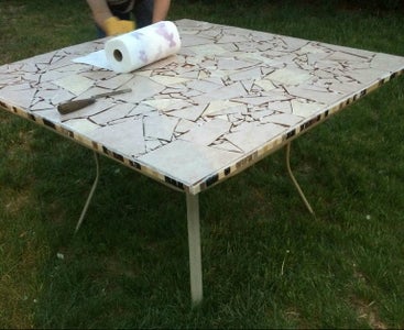

I could have used the full tiles and covered the table. I would have had to shave about an inch off the length and width of the plywood, but I could have made it work. I would have also had to drill a hole in the center of the middle tile with a ceramic bit, which I do have, but it's not large enough for the umbrella pole. I had a choice of grinding the hole with a Dremel bit for 5 or 6 days (exaggerating), rent a wet tile saw, or creating a mosaic design on the table. I opted for the mosaic because it seemed like the most fun.
I smashed all of the 16" tiles and for variety I also tossed in a few smaller 12" tiles that I had leftover from my Kitchen floor. I broke the tiles into pieces smaller than 5" across, but I was looking for variety and irregular shapes more than size.
I troweled out some mortar near the center of the plywood and used a cheapo plastic notched trowel to thin out the mortar to the desired thickness. I used the 1/2" notches. I laid the tile out with an interesting pattern, trying to fit the largest pieces wherever I could. You have to work quickly because the mortar will dry out. I had to back butter the smaller pieces with mortar, which made them sit a little higher than the big pieces, but overall everything is very level and smooth.
Step 4: Grouting and Finish
I bought a medium tan sanded grout to fill in the large gaps. I washed off the excess with a big sponge, but I tried to keep as much grout as I could in the cracks to try to preserve an even surface.

My second mistake was not spending more money on the thinset mortar. If I had spent a little more on a latex modified thinset, it would have been more flexible, waterproof and freeze proof. The small glass tiles that I used for edge-banding didn't stick very well. After 6 months, almost all of them have peeled off. I might have gotten them to stick better with the better thinset mortar.
