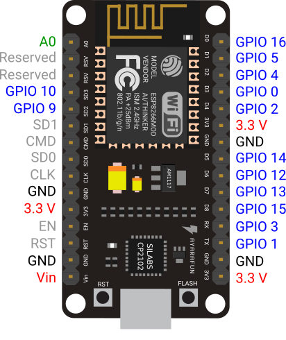

We'll start with connecting the hardware. Follow these wiring diagrams:
1 Connecting the Ultrasone distance sensor:
  • VCC of the sensor to the 5v pin (=Vin) FYI: the ultrasone sensor needs a 5v powersource, it doesn't work with the 3v power source.
  • GND of the sensor to one of the GND pins on NodeMCU
  • Trigger (Trig) pin of the sensor to D1pin on NodeMCU
  • ECHO pin of the sensor to D2 pin on the NodeMCU
2 Connect the RGB LED strip:
  • VCC of the LED strip to 3v3 pin of NodeMCU
  • GND of the LED strip to the GND of NodeMCU
  • DIN of the LED strip to the D6 pin on NodeMCU
