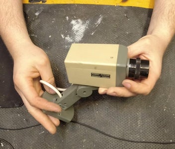

Step 1: Disassembly and Modification of the Case
Of course we start disassembling this dinosaur and under the main cover there is a slot for batteries, I tried to put batteries, supply it with DC voltage, but the LED never blinked. The ravages of time destroyed it.
I thought it only had the ability to blink, but underneath is the whole mechanism for turning the camera. I managed to start it only by directly connecting plus and minus to the DC motor and it came to life. It's interesting that it works, but it's also interesting that someone could think that this camera was real and not a fake one.
I don't know why it doesn't work with batteries, probably there was a break somewhere because the wires are very thin.
I'm a little sad to take it apart, but since I saw that you can buy them cheaply online, I decided to continue with removing the interior so that I could see is there room inside for stuff.
I keep all the parts and screws because I don't know what I will need. I am satisfied with how much space there is, I think it will fit 4 pcs of 18650 lithium batteries without any problems.
It will be necessary to cut, drill and grind a lot of plastic, but I don't think there will be any major problems in terms of space.

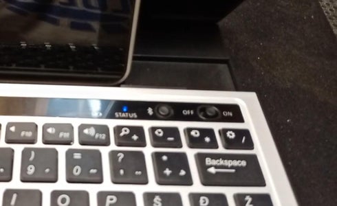

I will repurpose the battery that I removed from the mini camera for a Bluetooth keyboard.I have two, I repaired one with the 18650 battery I've been using for years and it hasn't discharged and it is great for workshop but I'd like to have one that's nice... and working.
After a couple of screws that I removed from the bottom I opened it easily with a plastic prying tool and it was easy to resolder the old blown lithium battery with a different one.

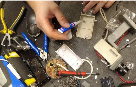

While I was testing the camera, I realized that it was heating up a lot, and in the same two places on both sides, the main chip and the camera are heating up a lot. Since I have a silicone thermal pad, I decided to put it under the camera and a small aluminum cooler on top of chip, and I glued everything with MS polymer so that nothing would move and, for example, create a short circuit.
Polymer glue comes in handy in cases like this, because it won't loosen when it heats up like some glues would, and it's easy to apply. Most often you can see these adhesives on commercial electronics and components such as capacitors.
While gluing it, I try to glue everything I have because I like to leave 24 hours for the glue to dry.

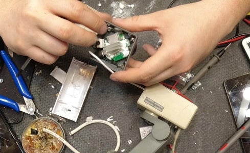

I finished testing the batteries, so I immediately prepared a battery of 4 cells, as I said, they are connected in parallel, whenever I save laptop batteries, I try to leave at least some nickel strip on them because I don't have an electric battery welder. When I leave strip, it makes soldering easier because the solder stays on them and the heat doesn't spread directly to the batteries as much, I know that lithium batteries shouldn't be soldered, but what can i do?
I have approximately a 6000mAh battery, which is a big improvement over the original batterie, and I think that I should be able to record over 24 hours with it without any problems.
Everything seems to fit without a problem, I m planning to replace its fake cable with a real USB cable and I connected everything with a TP4056 charger, but I'm missing the on/off option, so I'll use the original hole and switch, but the original switch was faulty so I took another one from a solar lamp and I did put just in case a 3 amp fuse ,The charging current will never be higher than 1 or 2A.
