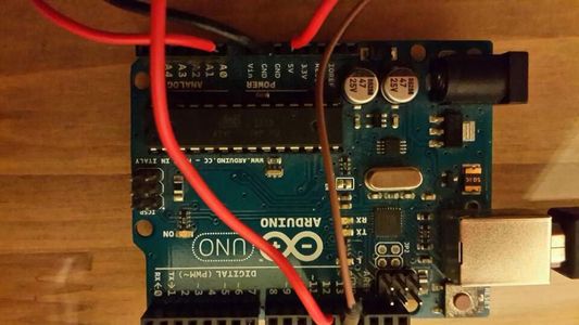

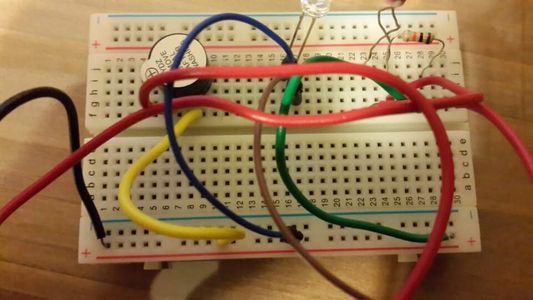

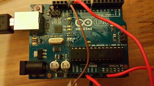

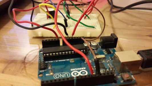

Step 3: Wiring
The first thing I connected the ground at the edge of the breadboard with the wire. This makes it's rows to have the property of ground. In the coding I set LED pin at pin number 13, Buzzer at pin number 12. So I connected the pin number 13 with the positive side of LED with the wire and the negative side to the ground. Then I connected the pin number 12 with the positive side of Piezo buzzer with the wire and connected the negative side to the ground. The positive side is the long leg and the short leg is negative. I connected LDR with the resistor, sharing one legs each. I wired the empty leg of LDR to 5V. Then I wired the empty leg of resistor to the ground. Finally, I wired A0 to the remainder leg of both LDR and the resistor. I uploaded 4 pictures in case you guys can't figure out the wires, since it's messy. Even with the 4 pictures, it's still hard to understand so I prefer watching it in fritzing...^^
