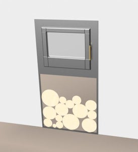

Now plan your design. The hole I was filling was 1,240mm tall and 640mm wide (49" x 25"). That’s too tall and thin to be just a stove, which is why I made a dummy log box to go beneath it. Work out what will look best in your room and sketch it up, with dimensions. I found it helpful to look at online images of woodburning stoves to see what proportions look right, both in terms of overall width and height and the dimensions and position of the door. Many stove manufacturers give the key measurements on their website, so you could just copy one that you like the look of. If you have a short, wide space instead of a tall thin one then a log box could go to one side of the stove, or on both sides.
To help me visualise the fake fireplace I was aiming to build and get my friend's approval, I modelled it in Fusion 360 and rendered the image above. I also created a dimensioned drawing and printed it off so I could scout for materials that would be useful while I was out and about - offcuts of plywood and MDF can often be found in skips (dumpsters) outside houses where building work is going on. The measurements changed a little as the project progressed and as I sourced various materials, but it was still useful to have a drawing to work from.
The dummy stove has 3 layers mounted on a backboard:
  1. a stove front made from 6mm (1/4”) sheet material
  2. a stove door made from (18mm / ¾”) MDF, shaped to mimic cast iron
  3. glazing behind the stove door
The log box is mounted on the same backboard and consists of a frame made from strips of wooden moulding with log slices arranged inside it.
Although the backboard needs to be a single piece of plywood, the stove front could be made from 4 strips joined to form a rectangular frame. That’s what I did because I didn’t have a piece of thin sheet material big enough for the whole stove front. Either way, keep the weight down by making the rectangular hole within the frame as large as it can be, but it does need to be smaller than the stove door so that the door completely hides it. As well as the weight issue, it’s best to have that hole in the stove front because it creates a gap behind the window and the added depth makes it look more realistic.
Bear in mind when choosing materials for the stove front that it must overlap the edges of the backboard on all sides. I made this overlap only 15mm (0.6"), just enough to be sure that the edges of the hole would be hidden. It will prevent the fake fire from falling back into the opening. Similarly, the wooden moulding you use to define the 4 sides of the log box needs to be wide enough to overlap the edges of the backboard by the same amount and be capable of being fixed securely to it. I used 20mm (just over 3/4”) half round moulding, I don’t recommend going any narrower than that.
