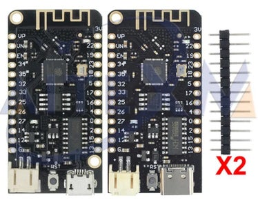

2 x ESP32-Lolin32-Lite (or eq)

For this project I used 2 ESP-32 modules (Lolin32 clones in my case, but many types of ESP32 will be OK), making use of their BLE (Bluetooth Low Energy) onboard transmitter. One is used as a IBeacon and the other as a beacon scanner. You can buy two of them at chinese websellers for three dollars (or euros). I have found mines on AliExpress here
The first module is used as a simulated radioactive source, emitting a signal periodically. We don't make use in this application of the data included in the signal, we are only using its name to identify the source (otherwise the Geiger counter would detect any BT emitter). The second one is used as a simulated Geiger counter, generating a typical "click" sound repeating in a pseudo-random pattern at a frequency related to the signal intensity, so to the proximity of the "source".
