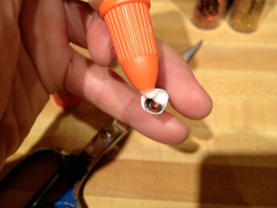

Step 3: Covering It All and Making It Look Like a Cigarette
-Take the piece of paper and make sure it fits over the whole "cigarette," with a little paper overlap - you can also let the tip of the bulb stick out a bit at the end.
-Mark a slight line where the "filter" will be (if you do it in pencil you can erase it later)
-Color the "filter" yellow (erase the pencil mark if you made one). If you want a brand name on the cigarette, you can write it in at this stage.
-Use a glue stick to glue the paper carefully over the cigarette - there will be extra room at the lit tip, you will fill that out later. You may need to use a tiny piece of clear tape to secure the overlapped paper edge.
-Fill the space at the tip with "white" glue - this dries clear, so don't worry about covering the bulb.
-Alternate dipping the tip, with wet glue, first into black, then yellow and finally orange glitter. You may have to add a little glue and go back and forth between the 3 colors to get it to look just right. Be careful not to squash the tip in the process, as it still has wet glue and extra space.
-let it dry fully overnight with the lighted tip at an angle, facing up.
