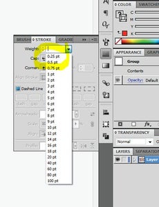

Almost any office supply store sells a variety of Avery or store branded peel and stick printer labels. For this project I purchased Avery brand #5265 full sheet labels. My intention is to put as many labels as I can on a sheet, not only to minimize the cost, but I will be putting sheet after sheet of labels into the laser cutter and frankly would like to minimize the number of times I have to do so. In this step, we will nest as many stickers as we can on the master sheet, add some alignment registration marks (more on the reason for this later) and create the necessary “print sticker” master and the necessary “cut sticker” master art work files.
Step 1: Group your artwork. Use the select all tool in your software to grab every item that now makes up your master sticker – all of the original artwork vectors, plus the outline created by the path offset command that will be your cut line.

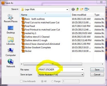

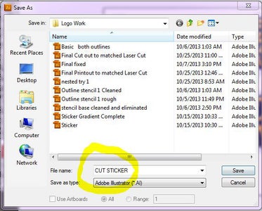

Step 6: Save Your Master Files
Step 5: Once everything is set, save your master document as master file. Print a copy of this document to your printer to make sure the printers margins do not clip any of the artwork. When the test print looks good, save two copies of the master document, one called “print sticker” and one called “cut sticker.”

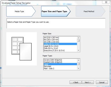

Step 9: Print a Pile of Labels!
If you have a set number of labels to print, look at your stickers per page count and do the math. Load that many sheets of labels into your printer, be sure to set your printer to LABEL if you have the option (if you don’t, you may want to try thick paper or cardstock if they are options.) Lastly, be sure to load the sticker side into your printer correctly so it prints on the correct side of the page – some printers print on the up side of the page, other actually print on the bottom side. If you aren’t sure, look for an icon on your paper drawer or feeder that shows orientation. Worst case scenario, write the word “top” in big letters on the top of a sheet of paper and print a trial sheet. Did the sticker print on the side that says top? If so your labels go in the tray face up
