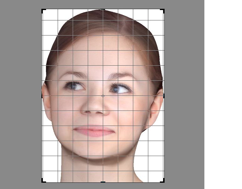

Let’s talk a little about the position of the image relative to the model. The slices are perpendicular to the z axis. The image could be set up either normal to the x or y axes. For now, we are going to set it normal to the x axis.
Ideally, you will be working with a model that already has a texture mapped to it. In this case:
1. Open your model in a mesh viewer. Turn off any perspective distortion (turn on ‘parallel projection’, or off ‘perspective’, depending on your program). Set you view to be normal to the x-axis, and take a screen shot. The positive x-axis should be going into the screen, or your image may be reversed.
2. Crop this image to the limits of the model and change the image size to be the same as the size of your model. The width of the image will be the y range of your model. The image height will be the z range.

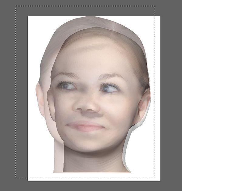

If you do not have a texture mapped to your model, but have a standalone image, you will need to project onto the model. Follow the first two steps using the untextured model. Then:
3. Load your projection image as a new layer. Adjust its scale, rotation, and position so that it fits over the model image (until you can make the image below look like the image above).
If your image does not align well with your model, you will need to either transform your model or distort your image so that it does.
