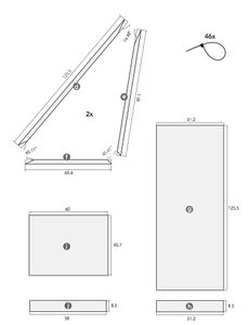

Step 1: Materials
Step 2: Joints

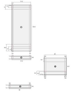

Step 3: Cutting Plan

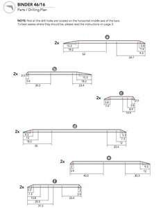

Step 4: Drilling Plan

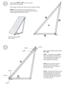

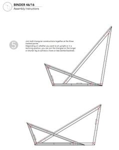

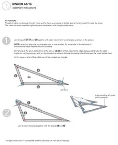

Step 5: Assembly Instructions
