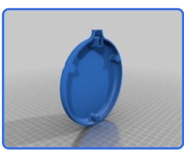

  1. Flag: This flag was 3D printed as a part of Phase 2 of this assignment. The flag is to attach to the Servo Motor and move one space every second for 20 seconds.
  2. Base: This base was 3D printed in phase 1. This is what hold the CPX, Servo, and flag.

Step 1: 3D Design Download
These are the 3D-printed materials that will be utilized for this design.

Step 5: Connecting the CPX to the Base
Description of step: Use a hot glue gun to glue the bottom of the CPX to the center of the 3D-printed circular base.
Step 6: Connecting the Servo Motor to the Base
Description of step: Use a hot glue gun to glue the bottom of the servo to the 3D-printed circular base above/next to the CPX device.
