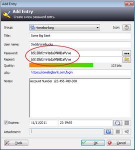

1) Keep all passwords in a secure password database. I use KeePass , which is free, open-source, and cross-platform. I'm sure there are other great ones you can find.
2) Store the KeePass database in the Cloud and share it with your immediate family. I use Dropbox, which is free, and can be accessed even if your computer can't reach the internet, since a local copy is always on your local hard drive. I'm sure there are other great services you can find.
3) I made a strong password, shared it with my wife, and sealed it in an envelope for my parents in case of emergency.
4) I carefully made a handful of identical USB keys with a secret keyfile on them, and I carry one around. I also put Mac and PC versions of KeyPass.exe on there, and made a simple batch file to open it up easily (actually make just one until everything works; see step 8)
5) I set up Keypass to require both the password and the USB keyfile to access the rest of the passwords.
6) I made new strong passwords for my banks and recorded all the other website passwords, most of which I did not bother to change. While I was at it, I tried to record other essential information in KeePass.

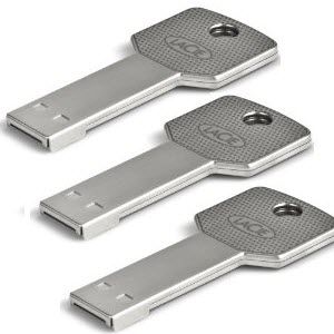

8) I tested everything and then duplicated the working USB key
9) I distributed the duplicate keys, one for me, one for my wife, one for home, and one offsite and trained my family.

The heart of the system is keeping a bunch of strong passwords in a password database protected by a master password and key. Thankfully there are products which help with this, so that it's done right. That's way better than using your own Notepad file or Excel Spreadsheet, though many people get by with that.
I chose KeePass, which is free, open-source, and cross-platform, but you can use any similar program. KeePass is makes it easy open your banking websites and to paste your credentials into their browser login forms. There are also browser-specific plugins for even more convenience and all kind of other plugins, but I don't use any of them.
It's a bit confusing that there are two separate flavors, KeePass v1 and KeePass v2, and they are separate products. KeePass 2 has some extra security features to thwart keyloggers, but I use KeePass 1 because I couldn't get KP2 working on our Mac. Supposedly it is possible, but it wasn't important enough to me to keep trying.
For Mac and Linux, you use KeePassX, which is technically a different program, but is 100% compatible with the KeePass1 file format.

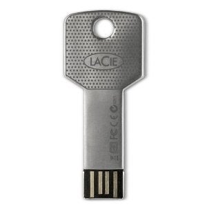

Step 6: USB Keys
The USB key will include several functions, the most important of which is to store your secret keyfile. What you should never do is to store the password database on there. For one thing, you don't want to store the password and the file together, and for another, you don't want any of the files on the USB key to change because it's difficult to synchronize them.
I chose the following USB device http://www.amazon.com/LaCie-iamakey-Flash-Drive-131104/dp/B004D2AZ06
because it was cheap enough and the reviews said it was very durable. Since I carry it every day on a ring with my other keys, that's an important feature. If you are going to carry it on your keyring, you probably want the housing to be metal rather than plastic or else use a short lanyard so that the key itself doesn't break.
Otherwise you can use any USB drive hanging around, but you will need to make some duplicate copies, so it's best to just go buy a set of identical drives all at once. I recommend buying one for each user plus two, one extra to keep at home, and an extra one for offsite storage in another town, covering the risks that your house burns down or a serious natural disaster hits.
The cool thing is that the key is useless without your memorized password, so you don't have to be extra-careful about it. I keep my offsite one in my desk drawer at work.
I recommend not using this USB drive for anything else, because that's just one more thing to remember to back up. Your data is better off stored in the Cloud. However I do put the KeyPass executables on the key so that I don't need to run a software installation just to use the system one time on a different computer.

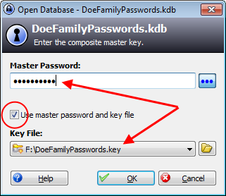

Step 7: Keepass Configuration
I don't use any KeePass plugins. If you do, make sure they get installed onto the USB drive.
If you don't read any of the other documentation, at least read http://keepass.info/help/base/keys.html so you know the basics of how KeePass keys work.
The main thing to do is to set up your password database for combined master password AND keyfile security (as seen in the image). For a new database, KeePass will help you create a keyfile. I don't like the default name, so I give it a similar name to my database so that I recognize it as an important file.
Most of the other KeePass options can be set as you see fit, and the default settings work pretty well.

Use KeyPass to generate a different strong password for each financial site you use. Now that you have a system for using strong passwords, you don't have to try to invent reasonably good passwords you can still remember.
For sites where security is not so important, like Instructables (sorry, but it's true!) or other bulletin boards, I re-use a few of my favorite passwords. They are still strong (not English words or names), but I don't sweat about using the same password on a few sites. I still store the passwords in KeePass so that everything is in there. Since I allow the browser to remember those passwords and don't type them very often, it's nice to have them in KeePass if I do need to remember them.
Any site which gets my credit card info gets a strong password. Whether you should ever give anyone your credit card number is a topic that I'm trying to stay away from, but ultimately that's your call.
KeePass is also great for storing account numbers and all the other information you or your family will need when accessing your accounts.
