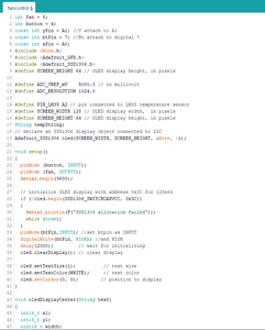

Step 1: OLED
In the first step, I downloaded the Adafruit libraries for the OLED display and connected them to the appropriate ports. I intended to use the OLED display to read real-time temperature values obtained from the LM35 temperature sensor, as well as to display the fan mode and status, similar to how fan controlling software is found to be in many modern-day gaming computers.

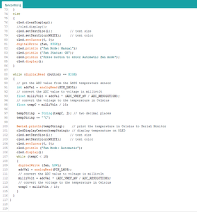

Step 4: Temperature Sensor
I wired the temperature sensor's outer legs to ground and power, then connected the middle leg to an Arduino digital pin. I used the temperature sensor in my control system's Automatic fan mode to save energy by automatically disabling the DC fan when the sensor reads a room temperature of less than 18 degrees Celsius. When the push button was pressed, it also displayed real-time room temperature, allowing the user to understand when the fan would turn off.

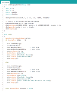

Step 6: Final Program
The first section of code simply declares all variables, including the ports to which each component is connected, as well as the OLED and LM35 libraries. In Void Setup, I specify the push button as an input and the fan as an output, and then, on line 30, I initialize the OLED display and configure the font size, text colour, and position. When called at a specific position on the screen, the function "Void oledDisplaycenter" reads the temperature value from the LM35 and prints it. In line 62 in "void loop", I created an "if" statement for the joystick so that every time the stick is pulled to the left side and the x-value becomes 0, the Arduino board will read the analog value of the x Pin and do two tasks at once. It will first prepare the information to be printed on the OLED by selecting an appropriate position and font size, and then it will digitally write the fan value as "LOW" to turn off the DC fan. The fan mode and fan status will then be printed and displayed on the OLED screen. If these conditions are not met, the else statement at line 74 will take effect, allowing the fan to run as long as the joystick is not pulled to the left. At line 88, I added a while loop so that whenever the user presses the button, the Arduino will read the ADC values from the LM35 sensor and convert them to Celsius so that they can be displayed correctly after calling the "void oledDisplayCenter" function at line 101. Furthermore, while holding down the button, it will print a new Fan mode of "Automatic" so that the user can differentiate between the two modes using the OLED screen. Finally, at line 107, I added another while loop to turn off the fan if the temperature is less than 18. This concludes my project, and I would like to thank you for taking the time to watch my presentation.
