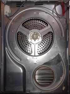

Step 1: Remove the Air Circulation Cover
First disconnect the electricity and the drain pipe if you have one, and move the machine out so you can access the rear.
Ok I forgot to take the picture of the cover in place, but we are talking about the big plastic blister on the back of the machine. Its top circle covers the main drum and the smaller bottom circle covers the fan.
You'll need to remove about 15 screws all around the edge, and three in the recess around the main bearing. DO NOT REMOVE the four screws in the centre of the bottom part.
Once the screws are out the cover is held in place by a tab in a slot at the top. Keep this in place while you ease the bottom out to give access to a multi-pin plug that connects the fan motor. Looking at the picture there is a clip just out of sight at left that releases the plug, just push it with a flat screwdriver. When the plug is disconnected you can remove the cover and fan all together.
