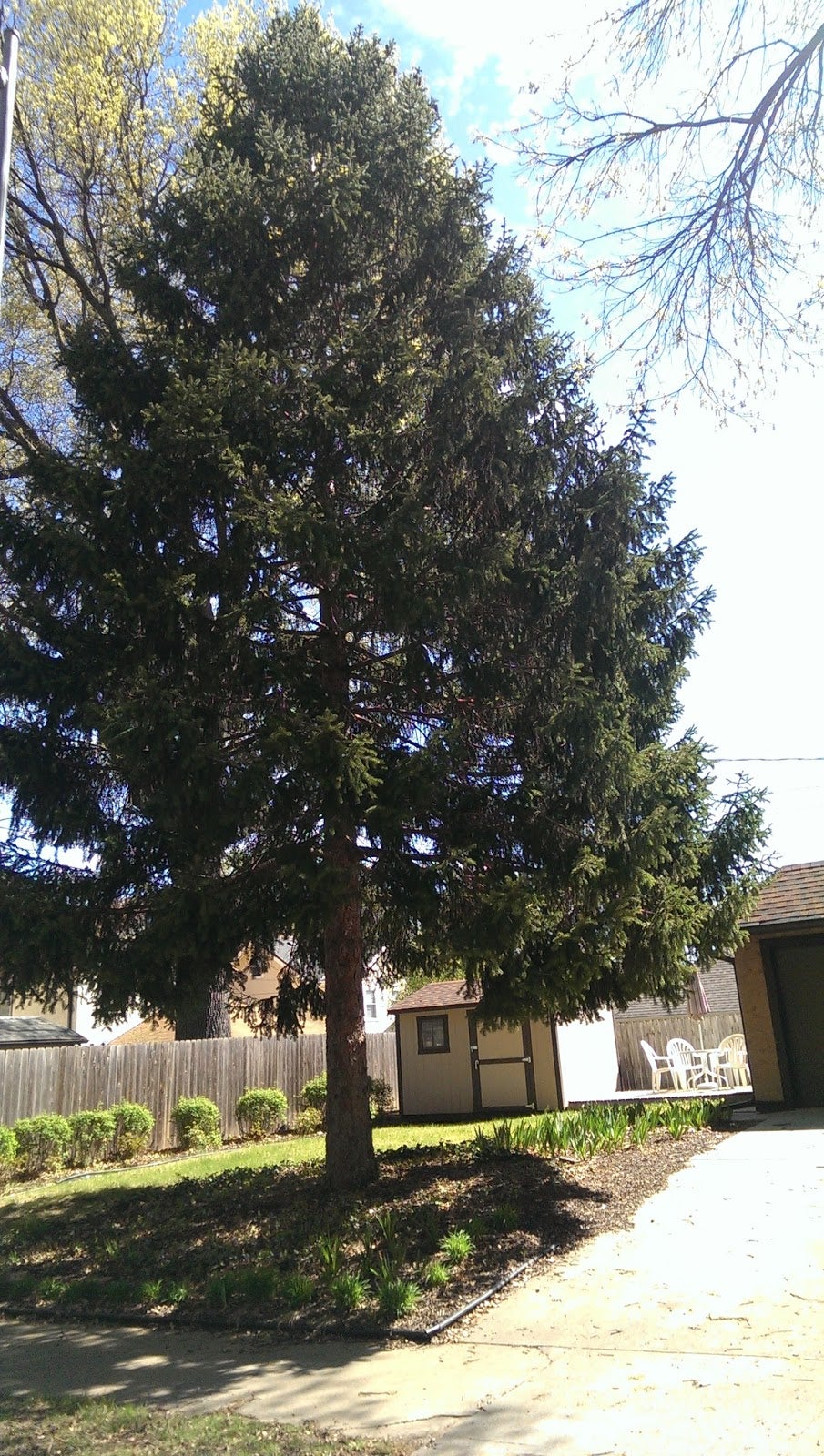

We spent a few days painstakingly getting our backyard ready to build this fence. We downed a large pine tree, got rid of a ton of ivy, slightly regraded the yard, and also took out as many irises as we could. The battle of the irises is not over yet as we still get 1 or 2 popping through the grass.
