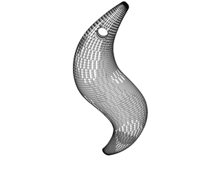

Step 2: Milling & Making the Rubber Mold
I won't go into details on how to use MDX-20 but I'll give some tips that I used
  1. Surface, rough and finish milling the wax. The 3D file is included.
  2. For Surfacing and Roughing the wax I use Ball Tip tool(bit) with diameter of 1/8 inches.
  3. For finishing I use 1/32 inches Ball Tip tool.
  4. After you mill the wax make sure to clean it.
  5. Gently mix as instructed the OOMOO liquid rubber and pour it into the mill. Wait until it becomes solid (I waited for a full day)
  6. As you might have noticed one of the molds was a failure due to the fact that the hole didn't form well. Pour slowly to prevent this from happening. You might be able to use a needle too to poke the hole and ensure the liquid is filling it completely.
  7. Your mold is ready!
