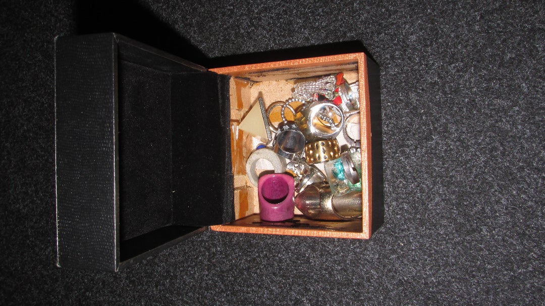

My girlfriend had a ring-related issue: her ring storage system was not only inefficient but also super lame (see Fig. 2)... No és bueno!
In this instructable I'll show you how I solved this critical, first-world problem. :P

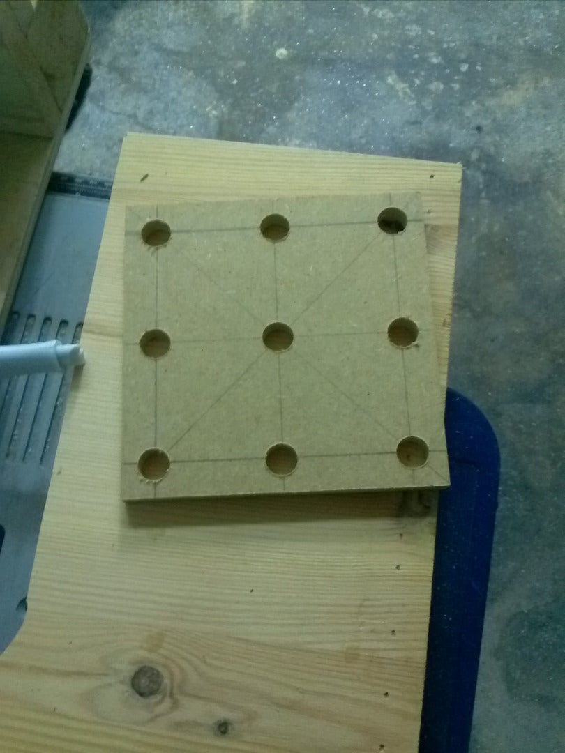

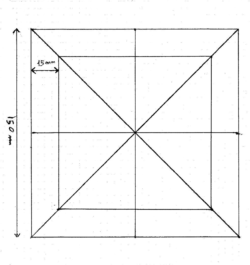

The first step is to transfer the template in Fig.1 to the 2 MDF boards.
Use contact glue to glue the felt onto one of the boards (Fig. 2).
Drill 15mm holes on the second one as shown in Fig. 3. This board will be used as a template for the dowels in the next step.

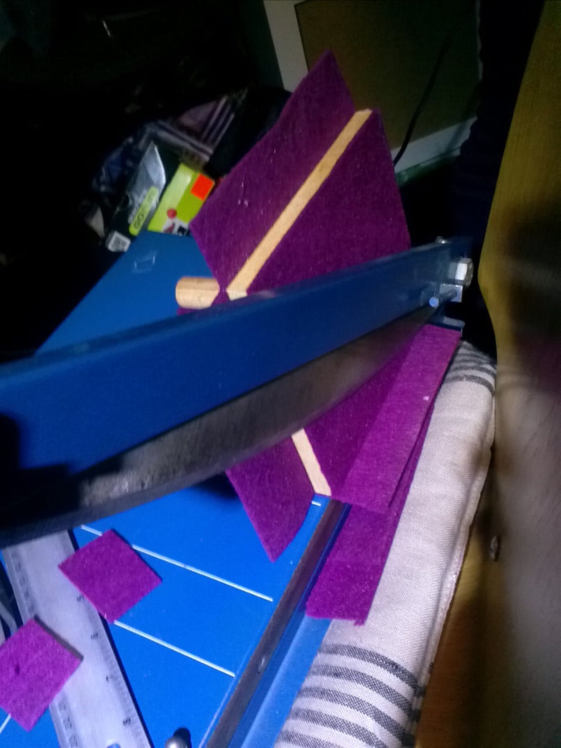

Use contact glue to fix the felt on the bottom.

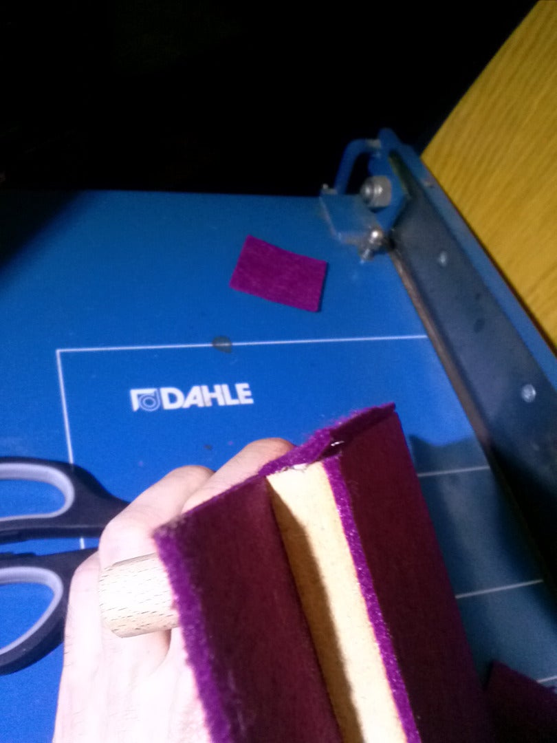

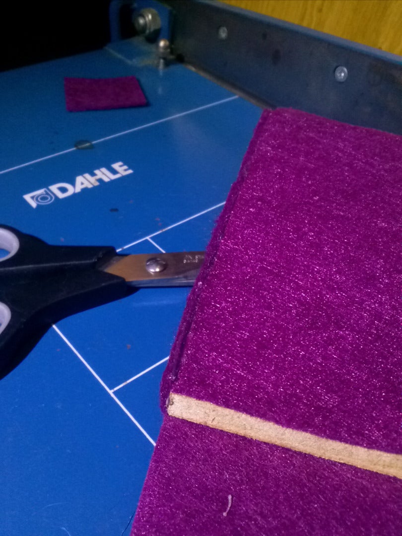

Trim the bottom felt to size and cut the corners of the top felt.
Use hot glue to hold the "flaps" it in place. You should try to add enough glue to hold them firmly in place, but not enough that it comes out when you bend and press the felt.
Trim as you go along using a pair of scissors or, ideally, a guillotine.
