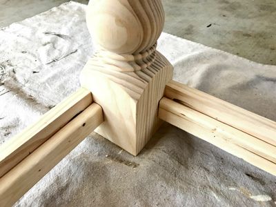

Step 1: Assemble the Frame
I used Osborne Wood's Shanty 2 Chic Coffee Table Legs in Knotty Pine.
The frame was constructed with pocket holes made with my Kreg Jig R3 (aff).
The top apron is 1"x4" Select Pine boards. The bottom apron is 1"x3" Select Pine. I used a 1/8" thick piece of paneling to create a setback for the apron.
Get the full measurement and build instructions on my blog.
Create the short sides first.
Then add the long pieces to connect the short sides.
