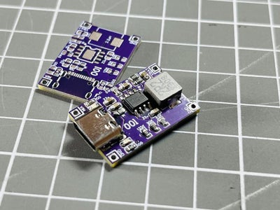

I made this IP2312 based module which has same form factor as the popular TP4056 one.

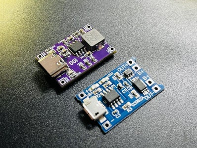

TP4056 is the one of the most popular modules available in very cheap prices to charge the Li-ion batteries. And to protect the batteries from overcharge, over discharge and protect the batteries by charging with constant current and constant voltage method. It has onboard MOS based different IC for protection with TP4056. The module is quite good but the IC TP4056 dissipates a lot of heat while charging. Which I think is due to linear voltage regulator section inside the IC.
Which also limits the overall charging current, because it is very over valued to add a heat sink on this module. And I think it is not the efficient way of charging nowadays. As a solution to all of this I came here with a new module based on IP2312 and designed by me keeping the max current of 3A in mind. Yes! this board comes with fast charging and protection features and all of them are listed below. You can see the PCB files given below, which can be used to order this board from JLCPCB.

This is the Hardware level design I have implemented keeping all the noise and stabilization problems in mind. Tracks are made with enough calculations to carry max current hence delivering maximum power and reduce heat effects. Two onboard status Led’s is to monitor battery charging. And to keep all the effects of switching section minimal on the input and output the PCB is divided according to the input to output flow. I kept the form factor same as TP4056 board, which makes this design more practical and easier to use as a standalone battery charging device. For input power USB type C and solder pads are given same as TP4056 design.

When soldering, the best practice is to mount IC and USB connector first. Then small capacitors, resistor and then Inductor. Because the IC pad and USB connector are very hard to solder with hand. If you don’t want to assemble the board then JLCPCB is the best to option to go with. JLCPCB is the only manufacturer offering SMT assembly services in lowest prices. And we don’t have to worry about the components, JLCPCB can source components from LCSC.

I supplied the board with my variable power supply and I noted that as battery voltage keeps on increasing the charging current reduce. So, we can say the max charging current 3A is constant for a little while when battery is fully discharge and then reduced to nominal value of 1.5-1A. See the comparison given below between TP4056 and IP2312.
When charging the battery at full potential a very little heat is produced, which satisfies the 94% efficiency of this IC. I also have tested all protection features and all of them are working very normally. It is always recommended to check the output voltage of board which should be in the range of 4.15-4.22 volts for Li-ion battery.
Step 7: Comparison With TP4056:
I have tested both the boards with same battery one after the another, the battery is charged to 4.0 volts initially. The results are obtained to charge the same battery for 10 seconds with these boards. So, we can say battery voltage is constant in this 20 second testing period. With TP4056 the max charging current is 450mA and with TP2312 the same battery charging current is measured nearly 1A. In all, it doubles the charging rate, increase the overall efficiency and covers almost all protection features.
