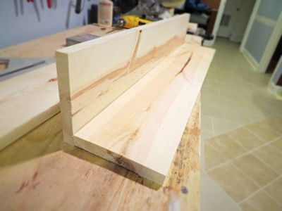

Step 5: Connect
Align your boards where you want them perpendicularly, drill a couple pilot holes, then attach from behind so the screws are hidden. Glue if you'd like for added security.
