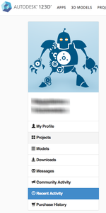

In the browser login to your profile on 123dapp.com and download your file.

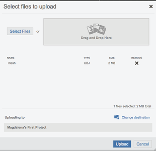

On the upper left side choose to Show the Data Panel and then click on the Upload icon (cloud).
Drag your .obj file to the designated window and click Upload. Double click on your uploaded file preview to open it. You can close the Data Panel now.

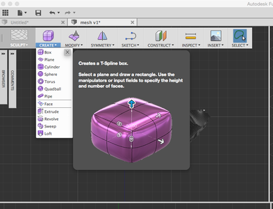

When you're done go to the upper left side to Create >Box. Adjust the size of the box with arrows in each viewport to adjust the size of your mesh model. Using blue sliders add divisions to this box. the more complicated your mesh is the more faces you'll need. When you're done right click and choose OK then right click again and move your model in each viewport to match the position of your mesh.

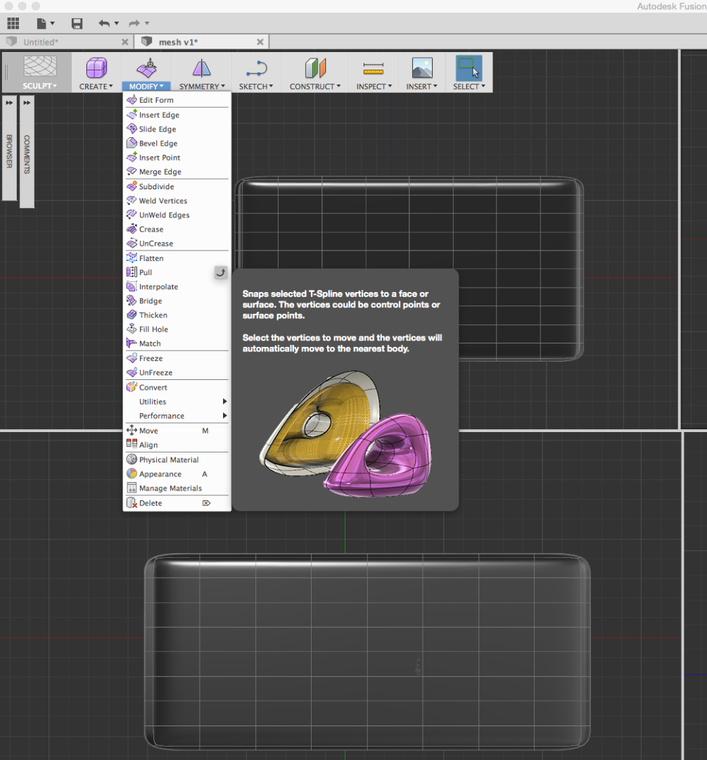

Ok, now you're ready for some magic! Check that you're in the Sculpt mode (upper left side) then go Modify>Pull.

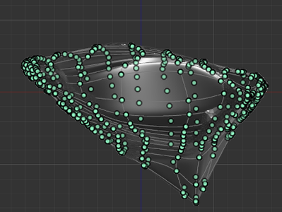

Go to Select and choose Window Selection. Drag the window over you box, confirm with OK..and voila!
You have a beautiful T-spline form matching your mesh model. Now you can delete your mesh.
