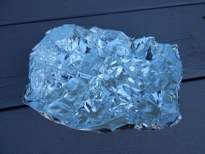

  • Tin Foil roughly shaped into the form of a low dish.

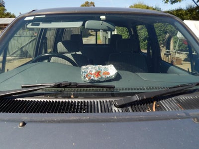

  • Two or three sunny days. The bluer the sky is the better (see picture).
  • A car. The car doesn't have to drive. Any car will do providing the glass is in tact and it's parked in the sun. A black car would probably be better than a white car, but I don't think the difference will be great. I'm using my 2003 silver Hilux - I love my Hilux.

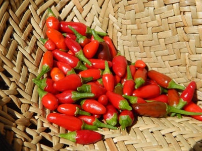

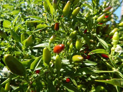

  1. Get some chillies. I grew my own so I only needed to pick the lovely red ones off thier little bushes.
  2. Place the chillies in the foil dish.
  3. Make sure the car is parked in the sun.
  4. Place the foil dish of chillies on the dash board of the car.
  5. Wait. Depending on the weather this process may take two or three days or even longer. There is no harm in using the car at this time - just take care cornering or off-roading or your hard work might slide out the window.

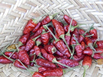

  6. When the chillies are obviously dry and wrinkly, and crumble when you squeeze them, they are ready.
  7. Store in a cool, dry, dark place. Or in the freezer to be double sure.
You can use these in any recipe asking for dry chillies, they can be ground into flakes or powder, they can even be soaked in water to reconstitute them (sort of). I love to break a couple into noodle soup - Yum.

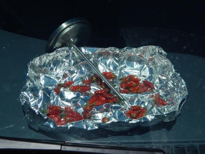

Step 4: An Interesting and Very Scary Side Note...

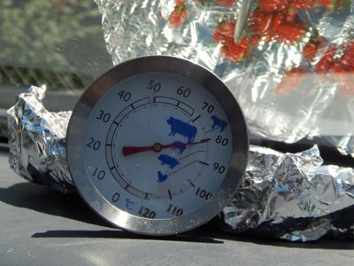

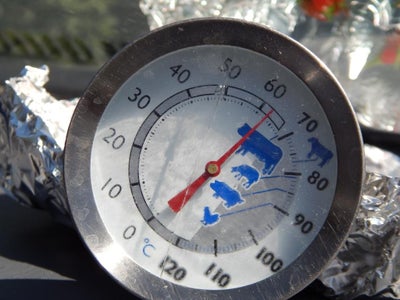

Just for curiosity I placed my cooking thermometer on the dash with the chillies. After a couple of hours I went back to check on progress and was shocked to discover that the temperature was a blistering 81 degrees C. For those used to impractical archaic units of measurement that is about 178 degrees Fahrenheit.
This on a 31C day (88F) at about noon.
As a parent, I consider this a terrifying reminder of the dangers of leaving children or pets in a car on a hot day. Nothing could survive that temperature for long - let alone a baby or small child strapped into a car seat. Please take care with your own car, and if you see any child locked in a hot car do whatever it takes to get them out - find the parent or even smash a window if you have to. Minutes or seconds could make all the difference.
