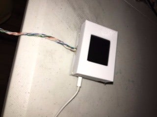

In this instructable you will learn how to make a spectral stethoscope using the fast hartley transform. This can be used to visualize heart and lung sounds.

Step 17: Seal Enclosure
Take the half of the enclosure containing the LCD screen and slip it over the other half of the enclosure containing the other components. While pushing the two pieces together, hot glue them to secure the enclosure together.

Step 21: Test It Out!
I used an online tone generator (http://www.szynalski.com/tone-generator/) to confirm the code was working properly. After confirming it works, press the bell of the stethoscope up to your chest, take a deep breathe and see what frequencies are present!!
