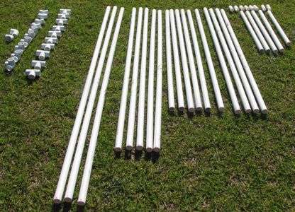

Step 1: Lots of Pipe and a Few Tools...
For the build, I decided on using PVC pipe. It's light, easy to work with, and to be 100% honest...it's super cost effective. Plus we can move it around the yard and even disassemble it, if needed, in case of a bad storm.
Once the design was finalized, I heading to Lowe's to pick up the needed materials:
10 x 1" PSI 200 PVC Pipe (10 ft) $2.46 ea x 10 = $24.60 (there was a 10% discount on 10)
Cut to:
8 x 2" Pieces of Pipe
1 x 21" Piece of Pipe
4 x 24" Pieces of Pipe (2 ft)
2 x 48" Piece of Pipe (4 ft)
4 x 50" Pieces of Pipe
5 x 60" Pieces of Pipe (5 ft)
2 x 72" Pieces of Pipe (6 ft)
2 x 1" Schedule 40 PVC Pipe(10 ft) $3.90 ea x 2 = $7.80
Cut to:
4 x 48" Pieces of Pipe (4 ft)
Connectors:
2 x 1-in Dia 90-Degree PVC Sch 40 Slip Elbow $.66 ea x 2 = $1.32
10 x 1-in Dia 90-Degree PVC Sch 40 Tee $.86 ea x 10 = $8.60
4 x 1-in Dia 45-Degree PVC Sch 40 Slip Elbow $.97 ea x 4 = $3.88
6 x 1-in Dia 90-Degree PVC Sch 40 Side Outlet Elbow $2.05 x 6 = $12.30
As for tools, I simply used a sharpie to mark the pipe, a hack saw to cut the pipe, the blunt side of a hatchet to tap the pipes together, and bit of nylon cord (not pictured) to tie down the roof. Oh, I also used a tape measure (not pictured)
