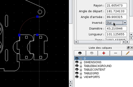

Optimisation using dxf2gcode
Dxf2gcode is written in Python and is published under the GNU license. Just downloaded, it converted form dxf to G-code.
I only inserted an export to dxf file after the optimising pass, using the scripts dxfImport from Christian Kohloeffel (GNU Public License). In this maneer, I get test4.dxf file generated with the dxf lines well ordered.
The mix of these two modules is attached, using the same license.
Unfortunatelly, I am not expert in python, it just handles LINE and ARC, there are problems with arc orientation when using with splines. If anyone wants have a look, I think it could be a great advancement!
Checking results in QCad
Sometimes the arcs need to be inversed. I edit test4.dxf and save to the final dxf.
Same work for each design.
