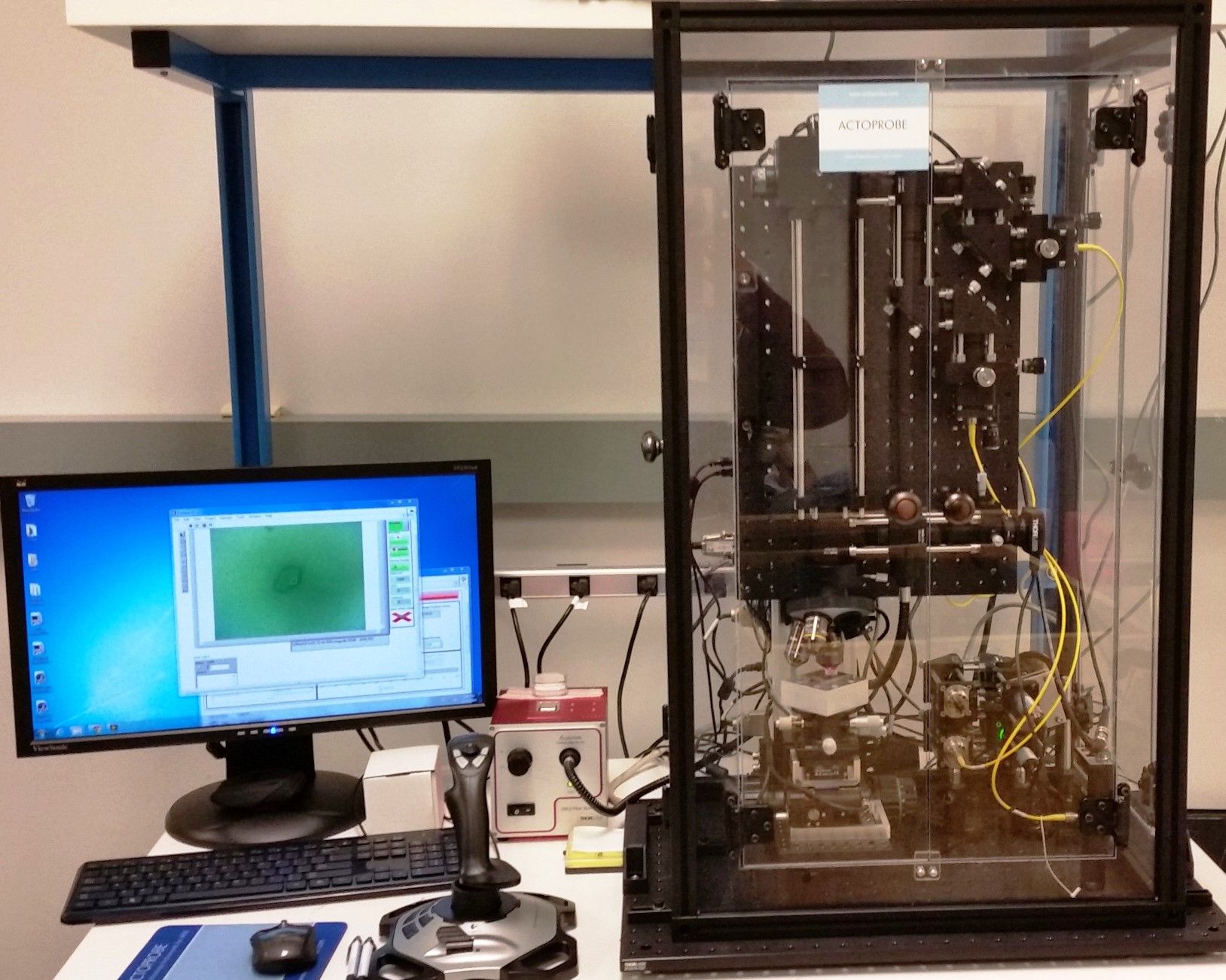

Motivation behind designing this shutter is speed, accuracy and variability (activation-time). In our optical tweezers we need to center the trap over a DNA-tethered bead, to get the DNA-overstretching geometry right (this affects the force measurement) and make our feedback program run. To center the tether we need to turn the laser intensity (trap) on/off quickly for various time intervals. To do this we used to use AOM (acoustooptic module), because it’s extremely quick (nano second on/off time). But AOM has some inherent oscillation problem which makes it use as a switch, unsuccessful. So I needed something else, (a shutter) which can replace this AOM function and can be controlled through a foot-switch (paddle).
This shutter does it exact and it is fast (activation-time) with an opening time of 4 and closing time of 2 μsec. The shutter runs on a +5 volts voltage. It moves to an on-position with an active voltage (controlled by the toggle foot switch) working against a restore-spring and remains on when the voltage is applied and turns to off when the voltage is removed. This gives a freedom of choice for the duration shutter is active with very simple electronics used to control the speed (activation time.)

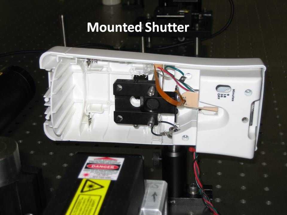

Now we are ready to put the shutter together. Start with the motor; most of the motors have little holes for the screws to hold pic 4&5. Choose a screw which can fit into that but still sticking out few millimeters. Next is the rotation stage which joins the cylinder to the motor and holds the spring assembly. I choose the wood for this function, because it’s easy to machine and a good thermal-insulator . I drilled two hole on both sides; to fit the shaft and 1/4 screw on either pic 6-10. To drill for 1/4 I used 15/64 size drill-bit. Now the motor can be attached to one side of the stage and cylinder to other pic 11-13.
Now we can machine the spring assembly. Slide 12 shows the parts of spring assembly. We need two metal strips of .75 and 1 cm long with a hole in the end for the screws. These strips with the screw on the motor will define the boundaries of the movement. Cylinder will rotate end to end between these strips. To screw the strips directly on the stage we need to drill two holes for the screws. The holes are 135 degree apart over the face of the stage as shown in the slide13. We also drill a small hole for the spring attachment near the edge.
Now all parts are ready to get together pic14-16. This shutter is little different of what is shown in the video/pictures but follows the same concept. Put the shorter end of the spring in the hole on the stage like pic 17. Now the motor shaft will go through the spring into the stage pic 18&19. The other side of the spring is hold against the screw pic20. You can twist the required number of turns before it holds to get the right restoring torque. Now the spring wants to move the stage clockwise but the strip against the screw does not let it (this is position 1). As the voltage is applied the motor turns counterclockwise working against the spring until the second strip stops it. When the voltage is applied the stage remains in the second position. As soon as the voltage is turned down the spring restores the stage into the previous position. These two positions can be chosen for the shutter to be on/off . In end chop/wrap the left over part of spring on the screw and mount the motor.
A fully assembled shutter is ready. Now the next task is to prepare a control box.
