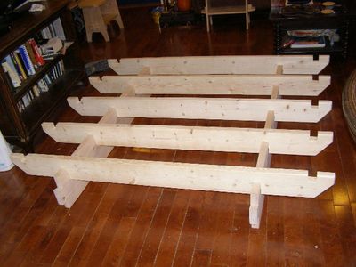

Step 3: Cut/Assemble Base
For this step you are going to cut four (4) lengths of 2"x10". You need two (2) pieces cut to 63" in length, and two (2) pieces cut to 43".
These four (4) pieces are going to be joined into a rectangle that is going to hold up the upper portion of the bed frame. The corners of this rectangle are going to be joined with one large and somewhat brutish through-dovetail joint per corner. The dovetails are cut in a way that they prevent the shorter boards at the head and foot of the bed from separating from the boards forming the longer side of the rectangle, or the sides of the bed. The longer sides are going to be held in place not only by the dovetails, but by the lap joints formed with the notches cut in the 2"x6" cross-supports above.
After cutting my pieces to length, I needed to start to cut the joints that would hold the whole thing together. First I cut the notches in the tops (2"x10" will be standing on edge) of my 63" pieces. The size of my notches is going to be 1.5"x1.5" (or just slightly larger, they need to allow the width of your 2"x6" within them). The layout is going to be the same on both of the 63" boards. There will be a total of ten (10) notches cut in this step, five (5) in the tops of each 63" - 2"x10". I centered one in the length of the board, and then made two (2) on either side at 13-1/8" on center.
Next I cut the dovetails into the ends of each board. I cut the tails on the ends of my 63" pieces, and my sockets in the ends of the 43" pieces.
I'm not going to go into the details of cutting a dovetail joint, but it is easily found with a quick search. To cut the dovetails I used an oscillating tool (rockwell sonicrafter), a hand saw, and cleaned them up with a chisel. There are many ways to do this.
Assemble the rectangle by tapping the dovetails together with a rubber mallet, your fist, or a hammer and block of waste wood. The dovetails may require some small adjustments as you go to assemble them, you want them tight-so adjust in small increments with a chisel.

Step 4: Cut 2x6 Cross Supports
For this step I started by cutting five (5) 2"x6" to 69" in length. These five (5) pieces are going to be exactly the same, I will describe how I made one.
On the top of the board (the board will end up standing on edge, so top will be one of the 1.5" edges) I cut two 1.5"x1.5" notches. I cut these notches leaving 3" between the notch and either end of the board.
On the bottom of the board I cut two (2) more notches, also 1.5"x1.5", this time leaving 13" between the edge of the notch and the end of the board on either side.
What remains is ornamental. I cut a simple 45 deg angle on the bottom corners of my boards and them chamfered the edges with a router.
Now these cross supports can be placed onto your base. The notches in the bottoms of the 2"x6"s should line up with the notches in the tops of your 63" 2"x10"
