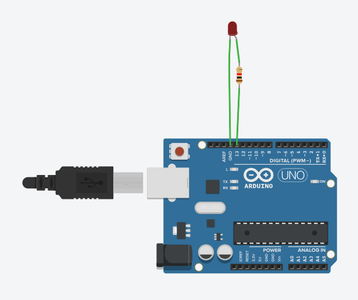

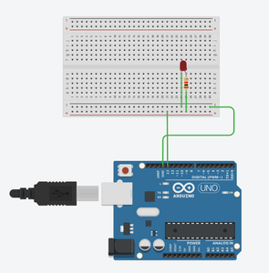

Either with a breadboard or just with some wires, connect the positive end of the LED to the resistor, and connect the resistor to the Arduino D12 node. Then connect the Ground end of the LED to a GND. Refer to the circuit diagram for more assistance.

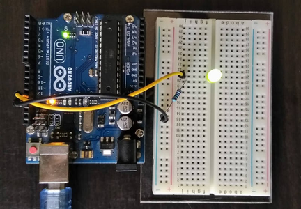

Step 4: Blink!
Your circuit should be successfully functional, the light should blink on and off at specific intervals. Enjoy your project!
