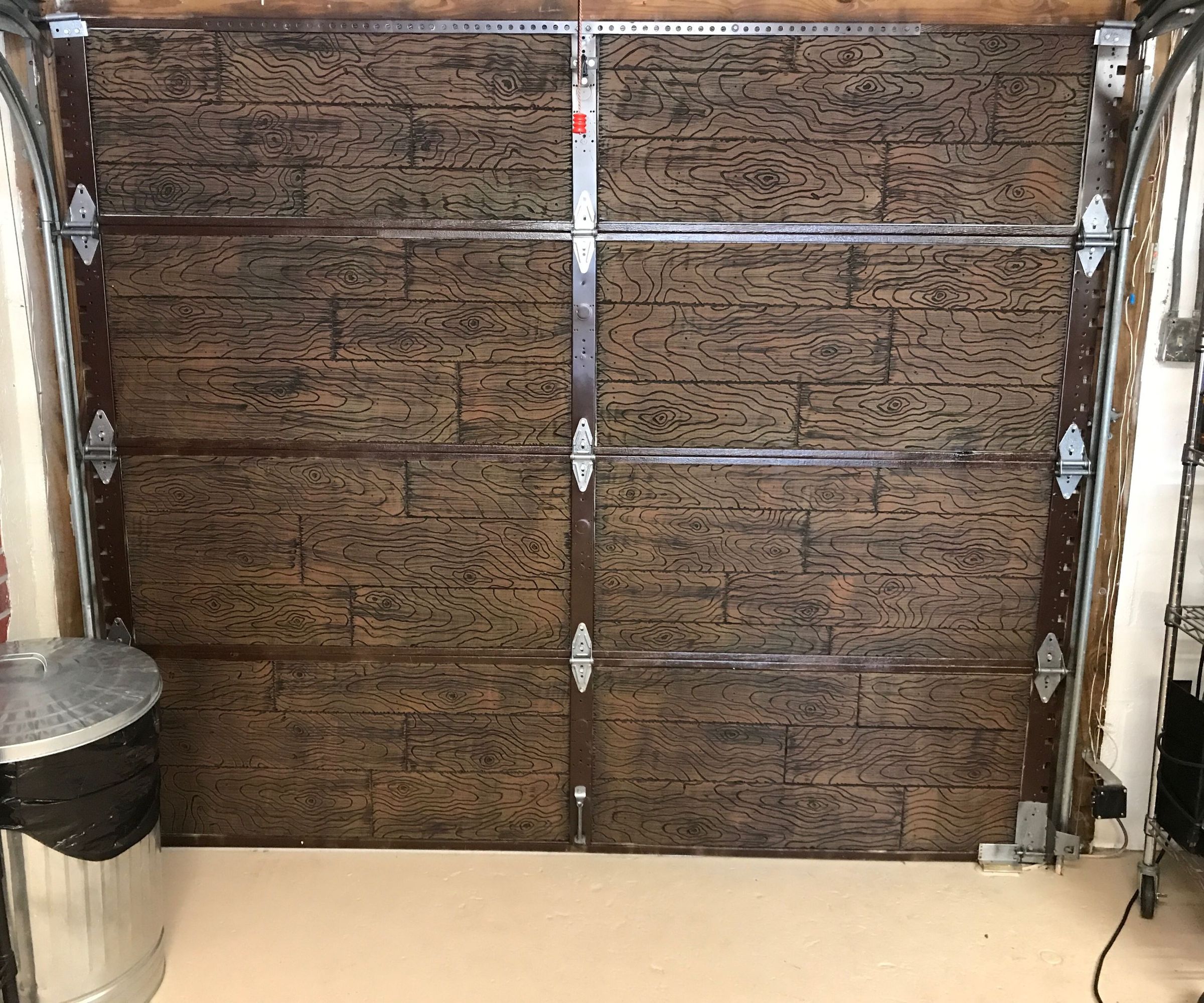

1. So the boards will be new....and they will look it. I first lay em out in the driveway for a day or so turning them over every few hours...try to dry em out as much as possible. To get rid of the bright tan and orange color I mix up a black wash. Just some black latex paint watered down.....enough to turn the water black. It goes a long way. I just brush the black water on and let it dry. This gives a nice sorta stained gray look as if the boards have been sitting for a long time.
2. So I like to get the unpainted boards done first. I stack a few up and drill a few holes, screw in several drywall screws, bang with hammer...just beat em up a bit...remove screws. I do this on all of the boards.
3. Using the hang held torch I start to go to work on the planks.....a few, I take extra time and go dark with the burning...a few I go medium....the burning really brings out the grain. I follow the grain with the torch to make it look more natural. So depending on how large of an area being covered you may only need 2 or three.
Step 2: Painted Boards
1. using my 2'x2' plywood I put a good few blobs of paint on it....in the center...about 3-4 inches apart with the stir stick. Using the roller I run it over the paint just a few times...you don't want to "load" up the roller.
2. run the roller over the board....it will look blotchy...just repeat this step until you get the look you want. I do one color at a time. Be sure to make them different....some with more paint, some with very little.
3. I did also ad some white on top of a few of the gray boards after they were dry
Step 3: Cracked Paint Boards
1. Start out with a base coat....when the paint cracks this color will show through.IMPORTANT!!! You can use a satin or gloss paint for the base color but NOT the top coat...it will NOT crack!! I used black and dark brown but have used other colors.
2.After the base color has dried very well paint on some Elmer's glue...I use a brush...with a plastic cup I filled with some glue....a good medium coat. I do 3 boards at one time.
3. You MUST watch the glue....when it gets tacky it's time to put the top color on. If you let the glue dry it didn't work as well. Brush on a medium to heavy coat of top color.I used flat white. DO NOT keep going over the top...one or two brush strokes.
4. I have found that if you use a heavy coat of glue it seems to make bigger cracks.
5. Let the boards sit.......the effect will start to happen in about 10-15 minutes.
6. Once dry.....several hours. I splattered a bit of dirty paint water on them and wiped off with a rag. They just looked to clean and fresh....I also splattered some on the other boards.
