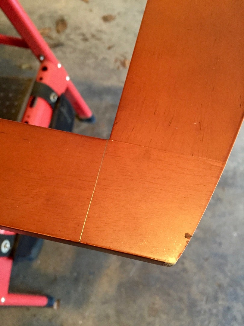

I then cut off the horizontal/short piece, first the one on top. I actually did one end at a time, to keep the integrity of the square. If I would have cut both ends, I would have had to put the mirror back on my work space, align the side pieces etc., etc. and risk the mirror getting damaged in the process.
At first I decided that I could use the top piece, that I had cut off the mirror earlier, as my new screw hook, because it had a nice lip, but I later decided against that when I realized that the piece was inferior to one made of plywood. So, please just disregard that when you see the old piece in the pictures. I had a few forth and backs, since I tend to not think my steps through sometimes, unfortunately.

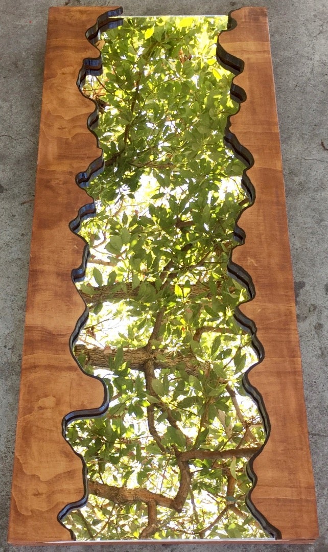

The piece of plywood I had in my garage happened to be just a bit longer than the mirror, so that worked out perfectly. I cut off the excess first and then went back to the mirror to measure how wide my live edges needed to be at least. Basically, I wanted to hide approximately 7" (see picture). Then I went back to my "drawing board" and created a pattern that resembled a live edge. I'll tell you, this is much harder than it looks. I had to actually "reset" for a second, because I was definitely overthinking it.
Now it's time to cut out your live edge, using a jig saw. It was really hard to cut some of the curves I drew, so I just did what we're taught in school when cutting with scissors. First, do a rough cut and then go back to refine it. That worked very well for me, except for the burns I created on the wood. Ups. But I sure loved the smell.
The last thing to do here is to cut the pieces to size, since mine were just a bit too long at first.
Step 6: Staining and Finishing the Wood

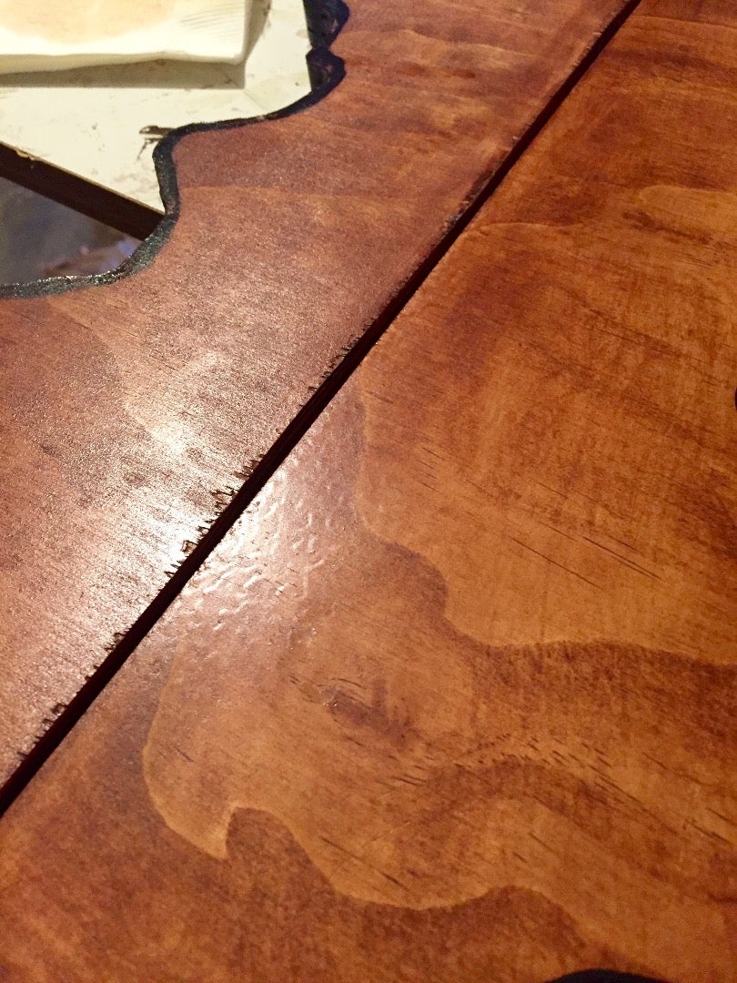

I decided that since I had two kinds of stain, one lighter than the other, that I would use a small brush to create a faux bark look, since bark is often still on a live edge. I drew a line along the edge of both, inside and outside of the live edges with alternating thicknesses, imitating true bark. Once that was dried, I applied stain to the whole. That caused a little of the bark/dark stain to vanish, so I reapplied another layer of dark stain.
This didn't take very long since this stain dried very quickly. The finish on the other hand took a while to dry, which is upsetting since it says it's "quick" drying. Whatever. For the inside I actually used a foam brush, for the outside I opted for a paint roller. I was much more happy with the results of the paint roller. Btw, while not using the roller, I wrapped it in plastic wrap to keep it from drying out. Also, be mindful of dripping stain or poly, that won't look too nice on the finished piece.

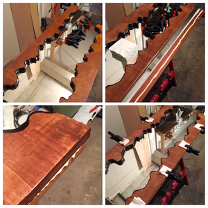

When everything had dried, it was time to finally attach the pieces to the mirror. I opted for glue first, then screws. Not much glue is needed for this and there will still be some that will spill out. I pulled out a few clamps as well as a bunch of napkins that I used to protect the wood from the marks of the clamps. Everything was aligned well, before leaving it to dry overnight for best results.
I'm pretty sure that the glue would have been enough, however, I'd like to be safe and so I also attached four screws from the back on either side. I did this by pushing the drill bit as far back into my drill as possible, which made it short enough not to go through both layers of wood. Another option would be to insert it the normal way and then use painters tape to mark how far you want to drill.
