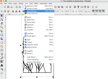

To create your own svg file for cutting, draw and upload (or virtually draw) your frame design in black and white in Inkscape. I used 1/8" line thickness and was happy with the tradeoff between cosmetic thinness and sturdiness. Select your drawing and open Path > Trace Bitmap. Use the default settings and click OK. Drag your image to the side and you will see there are now two images -- one with a transparent background and your original image. Delete your original image.
Finally, open the Fill and Stroke menu. Set Fill to no paint, Stroke to 255 Red, 0 Green, 0 Blue, 255 A (opaque). Set Stroke Style to .001" and save your file as an svg. Your design may become so faint it is almost invisible; this is expected. Your frame is now ready for vector cutting on the laser.
