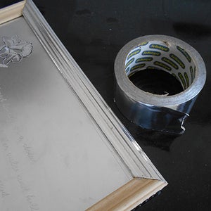

10. Now you can peel away the tape on the aluminium sheet on the lid to do your engraving.
GOOD TO KNOW: Print out designs and wording from the Internet. Make any adjustments so that it all fits on the aluminium sheet, after allowing for the frame that will be glued around the outside edge.
11. Using a #225 flexi shaft and #105 engraving cutter to make an initial outline through the template. Lift the securing sellotape from time to time so that you can check to see that the wording is clearly shown. Be patient and take your time with the individual letters.
12. After outlining the wording remove the template and repeat with a #106 engraving cutter. The daffodils were outlined with permanent marker before engraving with a #106 engraving bit. Wipe clean with a soft cloth and WD-40 or mineral turpentine.
13. After cutting and gluing the frame onto the lid, this was covered with aluminium tape. You could apply the tape to the frame before gluing it down.
