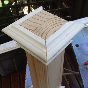

1. Cut your pine to length. The moulding is cut at opposing 45-degree angles using a mitre box. Cut enough sections to fit around the top and base of the pine stands.
2. Use No More Nails adhesive to secure the moulding onto the pine stands. Work front and back and let this dry before doing the sides.
3. Don't worry is the sections don't completely fit flush together, this can be filled in with wood filler.

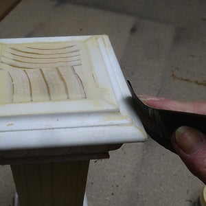

4. Use 120-grit sandpaper to lightly sand away any uneven edges and then apply wood filler to fill any gaps.
5. Let the wood filler dry and then sand smooth.
GOOD TO KNOW:
Don't use sandpaper on the extruded polystyrene as it will remove the surface and spoil the finish.

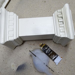

6. I used Rust-Oleum 2X in heritage white for this project because it's so easy to use, but you can use your paint of choice.
7. Apply 2 to 3 coats to cover entirely, allowing drying time between each coat.

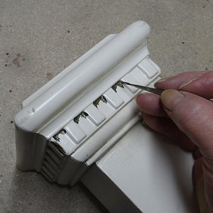

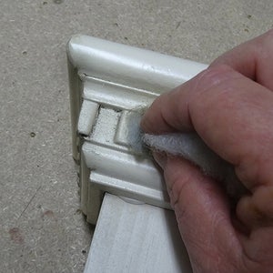

To give the candle holders an aged look you can use burnt umber oil paint or craft paint - either one works well. I used the oil paint because I already had some and I like the finished effect.
Apply the paint with a brush to nooks and crannies and then wipe away while still wet. You can re-apply if you are looking for more effect than that shown here.
