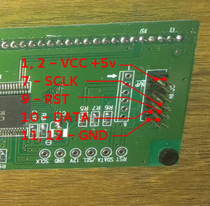

On the other hand, the pinout for the VFD was mutch trickier to workout. A close look at the components on the display module reveled the controler is an MSC1937-1. (and datasheet for this is largely available)... looking at the datasheet, I was able to figur where the SCLK, DATA, RST, VCC and GND are on the display processor. following them on the pcd (a multimeter did greatly help) gave me the following : VCC pin is on 1 and 2, GND is connected to pin 11 and 12, SCLK goes to pin 7 and DATA is on pin 10. RST goes from the controler to a quad nand gate who's input ends on pin 9. (Be ware !! the NAND gate reverses the signal, so when the controlers datasheet tells you RST is active HIGH, you have to set it to LOW in order to use the display... smarty manufacturers ;-) ) the rest is either not connected, or undifined but we already know enough to use it.

Because I didn't want to have multiple power supplie hooked to my Nagios clock, I decided to power the raspberry PI directly using it's GPIO pins. Since the +5v GPIO Pins (pin 2 and 4) are not protected, be very cautious with what you feed your raspberry pi. (If you don't, you'll turn your raspberry pi into a nice little smoke generator that will only work once.). When you take this option, the power supply must be a neat 5volts regulated power supply. Luckily, this isn't somthing hard to build. 2 capa and a regulator does the trick. Now that you have a nice and smooth 5 volt power supply, connect the ground to pin 6 of raspberry pi and pin 11 of the display. And of course, connect the regulated +5v to pin 4 of raspberry pi and and pin 1 of the VFD.
The rest is straigh forward, connect the following :
SCLK - Raspberry PI pin 11 --> VFD pin 7
DATA - Raspberry PI pin 13 --> VFD pin 10
RST - Raspberry PI pin 16 --> VFD pin 9
