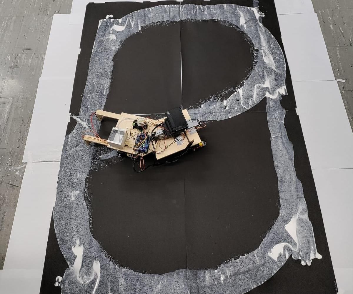

Johnny is your hungry and greedy four wheeled robot. Everytime it finds people or obstacles, it turns around and opens its box (mouth). Then you have to feed it money (coins). Then it closes and goes away in search of other people.

Firstly,  we imagine what our robot should look like in the final stage based on its functionality.Then we design each component according to the dimensions of electrical elements like breadboard, Uno and the  length of wires. In order to do that we Cut some plywood pieces  of 1 inch thickness as shown in the images below.
The 1st part is the base frame which is (17*20) cm2. It is connected with two side walls & one back wall. They are glued together to the base frame. They are permanent connections. We also have the partition wall between the uno & the box. There are two servo motor holders & a coin deposit plate. Also there are two servo motor holders, one for the head & the other for the box.
Now, there's a cap made out of 3 pieces & is connected to the side walls through means of dowels. as shown in the fig.

Step 5: Piezo & Led Circuit
The breadboard is placed inside the box & the Piezo capsule along with 2 led's are connected to the motor shield using breadboard. The 2 led's are put into the holes on the back wall & they show if the robot is moving or not.
Step 6: Code & Working
Mount the wheels to the motor. Upload the code by connecting the Usb to the Uno port. Now power the Motor shield with the AA batteries & the Arduino with the help of a Power Bank. The 4 dc motors start rotating & the robot moves forward until the ultrasonic sensor detects an obstacle within it's range. When it does, the motors stop rotating for 2 seconds. Then the motors rotate backwards for 2 seconds & the robot turns 180 degrees. then the 2nd servo actuates & the box opens. Now feed Johnny with coins through the coin collector below the box. As soon as the coin hits the floor, the piezo detects the vibration & the servo actuates to close the box. Johnny goes to find a new feeder
