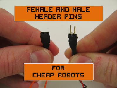

Introduction: Female and Male Header Pins for Cheap Robots
I apologize that this time my Instructable isn't going to be as impressive as my previous For Cheap Robots ones. As a college student, I have a varying workload, and for the past two weeks it's been somewhat high. Still, after my motor controller Instructable, I realized that I needed to add some header pins to my motors and figured I may as well make it into an Instructable as well! So here we are!
Connectors are hugely important. They see some of the most wear and tear when you're working on a project because chances are you're going to need to plug and unplug them several times over the course of trying out different configurations. Connectors can also be extremely important when you want to re-use parts, like motors, for another project. They have to be sturdy and generic so you can use them in as many different projects as possible.
This Instructable is all about adding a couple of very simple male and female header pin connectors to some motor leads. These style of connectors show up on everything from the Arduino to bread-boards, so they can be used almost anywhere! I'm also going to show you a couple tricks for making these connectors sturdy enough to withstand being plugged and unplugged all the time.
