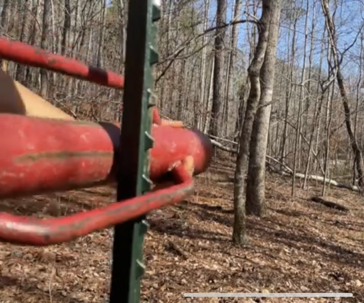

Step 1: Slide T-post Driver Handle Over T-post
Use the t-post driver as a fulcrum lever to lift the t-post straight out, by sliding the t-post driver down the t-post, between one of the t-post driver handles and the body of the t-post driver, until it rests on the ground.
Step 2: Wedge Handle Under T-post Notch
Make sure the handle is on the notched side of the t-post and the body of the t-post driver is on the opposite smooth side, wedge the handle under the notch.

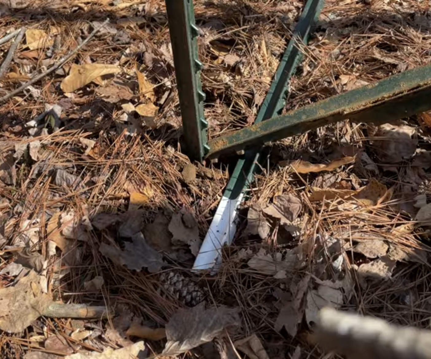

Step 3: Lift the T-post Up and Remove
Then lift up on the post. The t-post will become very tightly pinched between the handle and body of the t-post driver, with the protruding notch preventing the driver from sliding up the t-post. You might even have to beat upward on the notch. Pull up on it and keep sliding down a notch, until it’s out.
