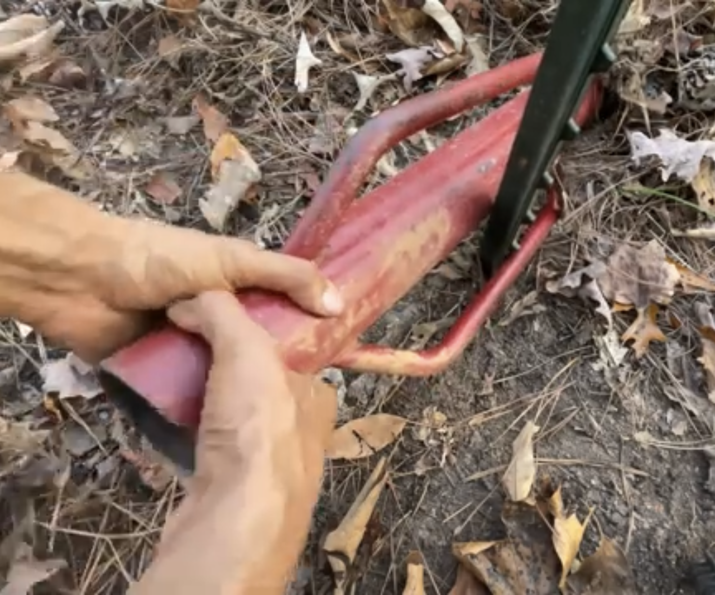

If you don’t have a t-post puller for metal posts and you don’t have a t-post driver. Just use two t-posts to make a fulcrum lever to pull up a t-post. No other expensive tool needed. I hope this saves people time and money.
DISCLAIMER!
This only works with t-post that have an even triangular notch. If the notch is longer on the bottom than the top, the end of the t-post is just going to slide off and not catch on the notch.
Step 1: Place T-post on Ground Beside T-post
Place a t-post on the ground next to the notched side of the t-post you’re pulling up. You can also substitute the t-post with a piece of wood or a rock.
Step 2: Wedge T-Post Under Notch
Use another t-post as a fulcrum lever by placing it on top of the t-post you laid down and wedge the end of the t-post underneath the lowest notch of the t-post you’re pulling up. Make sure the notch goes in the crease so it can pull up the t-post.
Step 3:
Push down on the t-post that’s wedged under the notch and start pulling up the t-post. keep sliding down a notch, until the post is out of the ground. Once it’s been pulled up far enough, you can just pull it out by hand.
