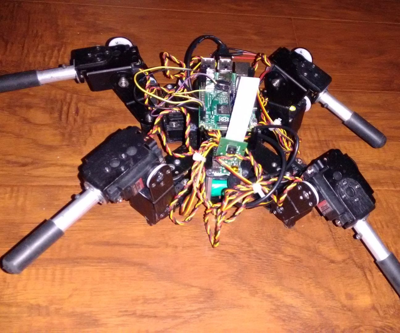

Step 4: Building the Body
The robot body consist of : 1 Spine Connector, 2 Spine, 4 servos.
  • First, connect the Spines Connector to the first Spines piece. There should be holes that allow the two piece to click right in
  • Then connect the the second Spine piece to the other side of the Spine Connector.
  • Make sure everything is secure. Add superglue if you feel that is necessary.
  • Finally, Put the four servo into the big opening on the Spine piece with servo head facing upward. Secure the servos with screws .
Grats, you have finish the first section of your robot. Time to put the leg socket on your robot.

Step 9: Putting on the Electronics
This part i will show you how to put all the electronics that needed on the robot in a neat and easy to maintain manner.
  • Place the Standoff pieces on the four hole in the Spine Connector. Then place the Anker battery inside the space of the four Standoff as show in Picture 1.
  • Next, place the Raspberry Pi 2 on to of the four Standoff. Use more Standoff or some screws to secure the Raspberry Pi in place. This will also make the Anker battery fight tight and should not slide around.
  • Next, screw down the Mini-maestro on the tail as show in Picture 3.
  • Finally, Put the Turnigy battery vertically under the body section of the robot. The 3 rod across the middle will prevent the Turnigy battery from falling out.
The construction of Fenrir is now 100% finish. Up next, I'm going to show you how to connect all electronics together and start loading in the code to make it move.

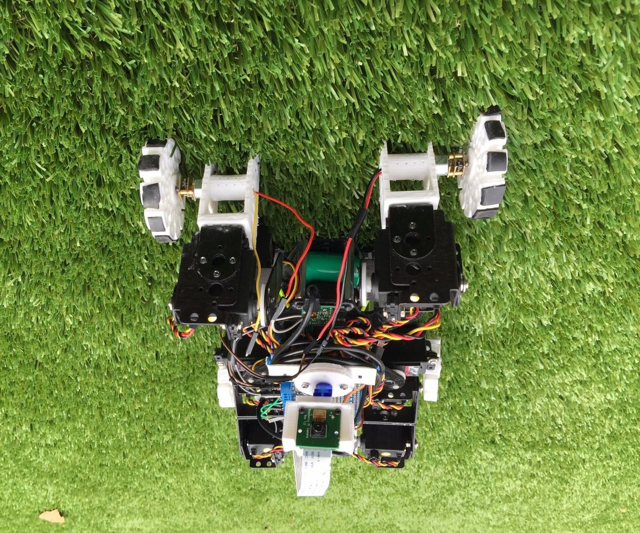

Step 10: Connecting Electrical Components Together
The electrical wiring and connection is fairly simple and straightforward. Every thing is plug-in ready so there is no need for any soldering tools.
  1. Connect the Pi Camera to the Raspberry Pi in the Camera port as show in Picture 1 and Picture 2.
  2. Connect all the servos to the Mini-Maestro, the ground pin is the outermost pin and the signal pin is the innermost pin a.k.a black facing out . Look at Picture 3 for pinout reference of the Mini-Maestro.
  3. Plug in the Turnigy 2300mAh Battery in to the Mini-Maestro. GND is the outer outlet and VCC is the inner outlet.
  4. Make the connection between the Raspberry Pi and Mini Maestro by using a USB to Micro-USB Cable
  5. Finally, use another USB to Micro-USB Cable (should come with the Anker Battery) to connect the Anker battery to the Raspberry Pi .
If everything was connect correctly, the raspberry pi and the Mini Maestro should light up to indicate that they are power and ready for use. For now , you can just turn off the power to the Mini Maestro band load up all the software onto the Pi first then power up the Mini Maestro again and test out the robot.
