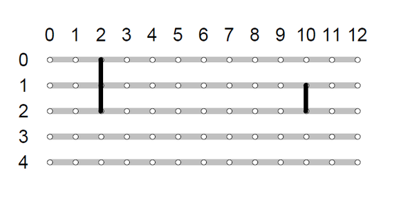

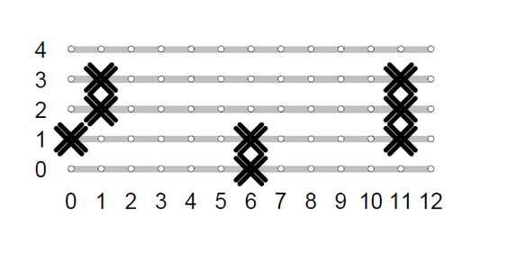

Step 1: Photomicrosensor Circuit
Build the Photomicrosensor Circuit
- Cut the stripboard to size
- Create the rear breaks
- add the front wires
- install the components

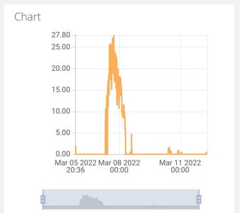

- I have calibarated the threshold* to a matching bubble cell of water
*If you want to use a different type of bubble airlock** type then you need to mark the water level and adjust the threshold value by trial and error
**I can update the calibration method if anyone is interested
Step 5: Monitor
Monitor the result using a combination of the bubble count results, specific gravity you can determine when primary fermination is complete.
- Specific gravity reduces rapidly
- Typiclly within 24-72 hours carbon dioxde is produced resuting in a rapid number of counts per minute (10's)
- Within 24 hours specific gravity levels out but still dropping
- The bubble count reducs to a small number of bubbles (1's)
- Within a further 72 hours the specific gravity is unchanging
- Bubble production is zero.
- At this point if you dry hopping then bubble production will restart but only for a mixium of 12 hours.
