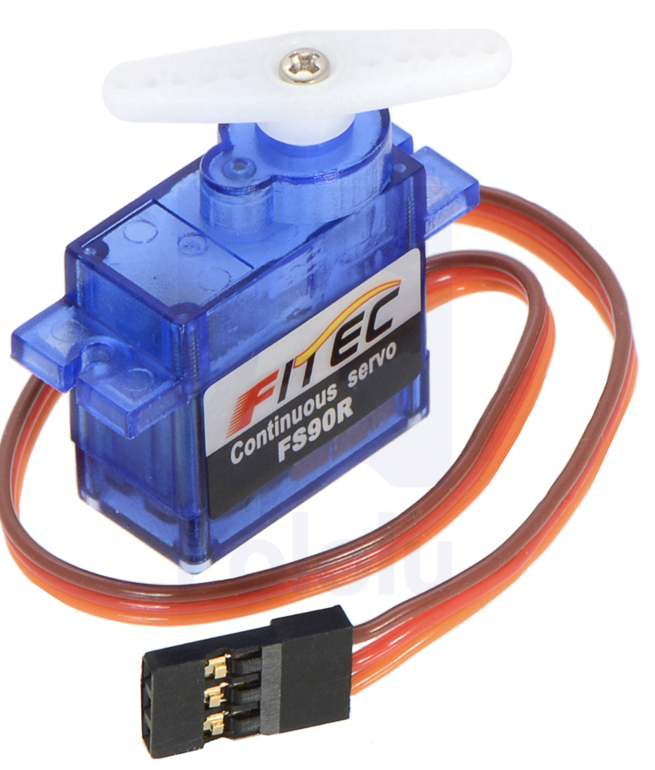

  • Continuous Rotation Micro Servo

  • Attaching the servo motor to the CPX
  • Using the provided wires, attach one wire to A1, one to VOUT and one to GND
  • Bend the end of the wire to secure
  • Connect the A1 wire to the orange wire on the servo motor
  • Connect the VOUT wire to the red wire on the servo motor
  • Connect the GND wire to the brown wire on the servo motor
