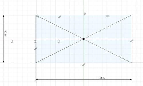

The frame supports serve as the foundation for this project. I made them a simple and unique design to handle the weight of the heavy and rotary parts that are attached to each other.
In my iteration, I made a 20-mm diameter hole to place my main rotary part through, while the two 10-mm diameter holes near the bottom is where the beam supports would go. For the thickness, I had it set to at 30-mm, but you can make any adjustment to the dimensions and design at any point during the process (same goes for all the other parts in this project). After printing the frame supports, I used my calipers to measure the diameter of the holes so that I can change the dimensions of my other parts in Fusion 360, if necessary.
The dimensions for the left and right standing frame supports are the same with the only difference being that the left one has the 'Autodesk' text extruded on its surface.

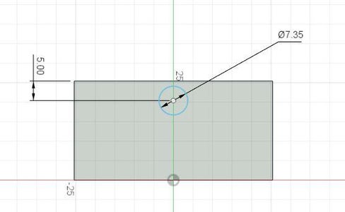

Step 2: Rotary Frames
The next part I designed were two rotary frames that would be placed through the large circular hole and would help move the storage shelves by rotating the red knobs with your hands.
My design consists of a 19.40-mm diameter knob extruded 56-mm from the center of the model that is 5-mm thick. I also made three 8-mm diameter holes that would serve as the placeholders for the storage shelves, as my design will consist of three box compartments.

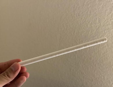

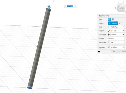

Step 3: Support Beams

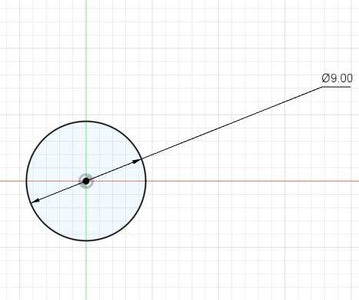

The beams served as extra support and stability for this project, as it is simply a 9.5-mm diameter beam that is 172.5-mm long. While printing out the beam, make sure it is properly stuck onto the hotbed, as there is a possible chance that it could pop off the surface and ruin your model.

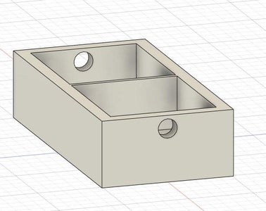

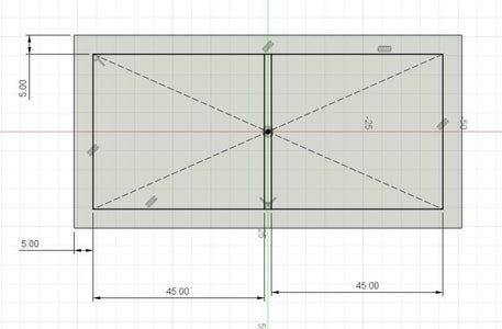

Step 4: Storage Shelves
These were the primary parts for this project with the sole purpose to hold small items/objects for later use. In my design, I had each storage shelf contain two separate compartments, as the design of this project would have three storage shelves. Originally, I made this design with circular extrusions on its side in Fusion 360 to fit through the small holes of the rotary frame. However, as I tried printing out the parts, the support parts that would of held up the extruded parts kept popping off the plate and ruining the overall model.
Instead, I redesigned the storage shelf with holes through its sides, and decided to make the circular extruded parts separately. Doing so reduced the complexity of the design and limited the waste of filament and time.
To ensure that the storage shelves did not touch each other nor interfere with the beam supports, the height of this box was 25.4-mm.

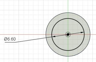

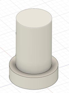

Step 5: Dowel Pieces
These small circular pieces are placed through the holes of the storage shelves, as I made the part long enough to hang on to the rotary frame and cause the shelf to move when rotated. In total, I had to make myself six dowel pieces, as one will go on each side of a storage shelf.
Step 6: Tolerancing Holes
Make sure that you have been checking the diameter of the holes/parts and thickness/length of every part, as this is a major factor in whether the dimensions were over/under-sized. During the project, I had encountered minor issues in which parts were not fitting together (i.e., diameter of the beam was too big to go through the hole of the standing frame or the diameter of the dowel piece feeling loose as it goes through the hole of the storage shelf).
Do yourself a favor, spend time checking the dimensions so that you can edit the parts on Fusion 360 to be accurate and have them fit properly.

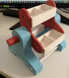

Step 7: Final Assembly & Closing Remarks
After making the parts, assemble everything together to produce the Ferris Wheel shelf. If necessary, use Gorilla glue to keep parts together and prevent the structure from loosening and falling apart.
Considering that this is my first time using a 3D printer, I felt that I did not do a bad job printing out the parts and assembling this creative and interesting project. Although I need more experience to build more complicated projects, I feel that this is just the beginning of something greater. If I were to improve on this design, I would like to make it bigger and support more storage shelves. In addition, I would integrate electrical components to make it remote-controlled or automated as well as light up with LEDs.
