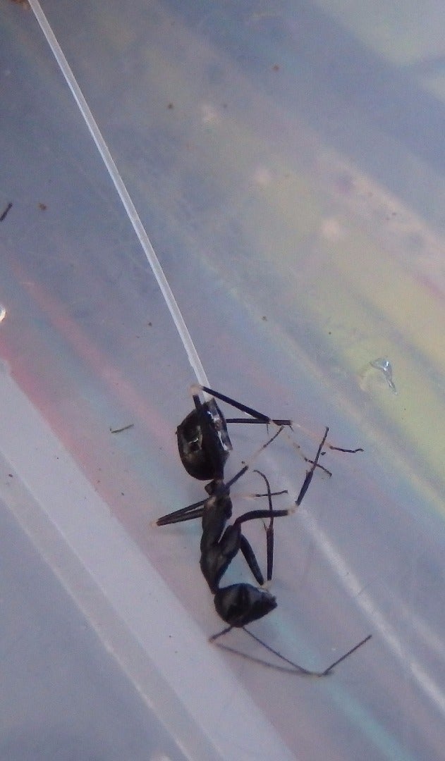

    • A Dead ant glued to a fiber optic line (for testing!) (very useful!)

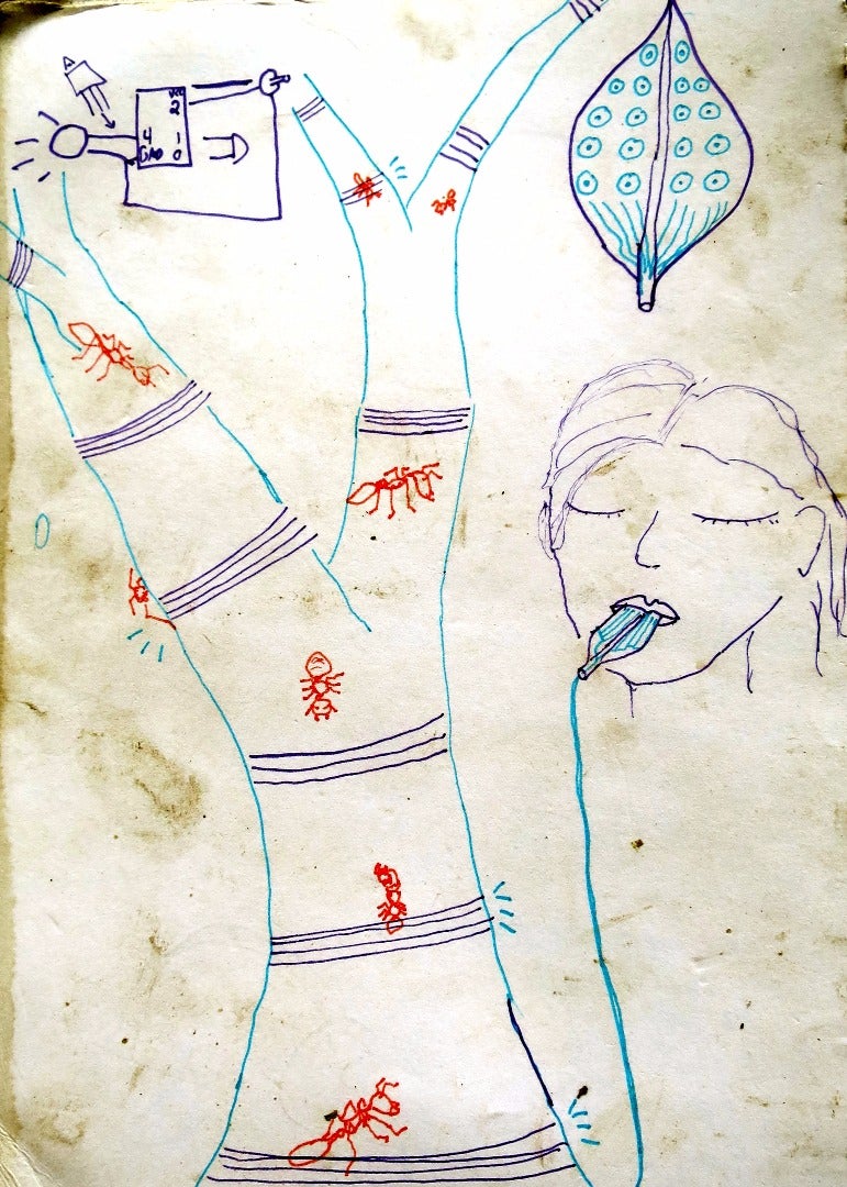

The basic concept is that we are making a flexible photosensor ground wire. Fiber optics are pieces of extruded plastic that can carry light from one end of a flexible tube, and emit it out the other end. Try it out, put an Led on one side of a bundle and see how the light moves through it!
If you scratch up the sides f the bundles however, the fiber optic wires will also emit light from the sides. The same works in reverse! If you put an a light sensor at one of the bundle of fiber optics, and the sides are scratched up, you end up with a long, flat surface that can sense the amount of light over it.

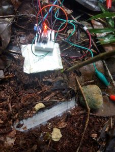

Then lay it on the ground where insects like to go, or wrap around a tree and secure with a tac, and test it out. You can even just hook up a multimeter to it and see if the resistance changes when bugs walk over.

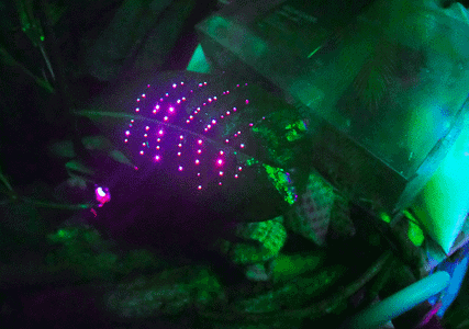

A cool thing about this project is that you could potentially use an LED as the light sensor. With that, you could detect AND display the results with the same light-tubes. This method has an advantage over the other in that the area that insects could be detected is somewhat more dispersed, but the change in the light hitting the sensor overall will not have as much impact from one little point being covered by an ant.
Our Tests
Our initial trials didn't function that great as a sensor, but it made for really gorgeous displays, especially at night in the jungle.

Step 8: Conductive Thread Eyelash Band
When Hannah came up with this idea, she referred to it as a basic "Wimper Switch." I thought this was some sort of electronics engineering term, but actually she was just meaning "eyelash switch" but didn't really translate it from the german. I like the name anyway.

Organic Breadboards
Originally, Hannah came up with this fun idea to use these mushrooms we found as breadboards. They work pretty well, hold things in place, don't get burnt. But for sensitive applications, especially ones that involve capacitance (like using an LED as a sensor), these screw up the electronics a bit. (But they sure are cool looking!)

We were able to sense beetles, and large ants. We got fickle results with small things.

Tongue Display
This worked quite well and was very noticeable (and unlike sound or vision, was not affected by the changing noises or lights in the jungle).
The wax tasted good.
It made me drool extra.
I could have embroidered the electrodes more nicely. Ideally i would have circles of conductive fabric cut out, and much higher resolution.
