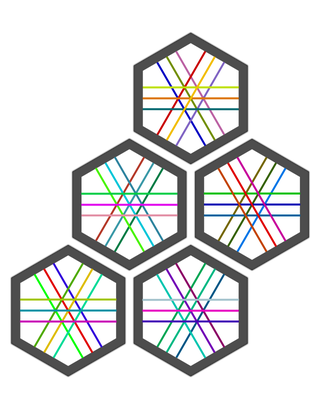

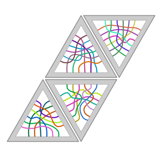

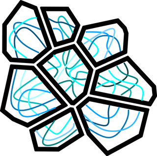

First of all, the fibers can be arranged in a more orderly way as in the graphics below.
Bodies don't have to have a square shape, do they?
They can be hexagonal
triangular
or even some voronoi shapes

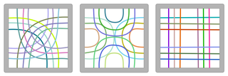

In the case of perpendicular fibers, the fibers can be woven as in a material or the bodies can be redesigned so as to allow the fibers to overlap.

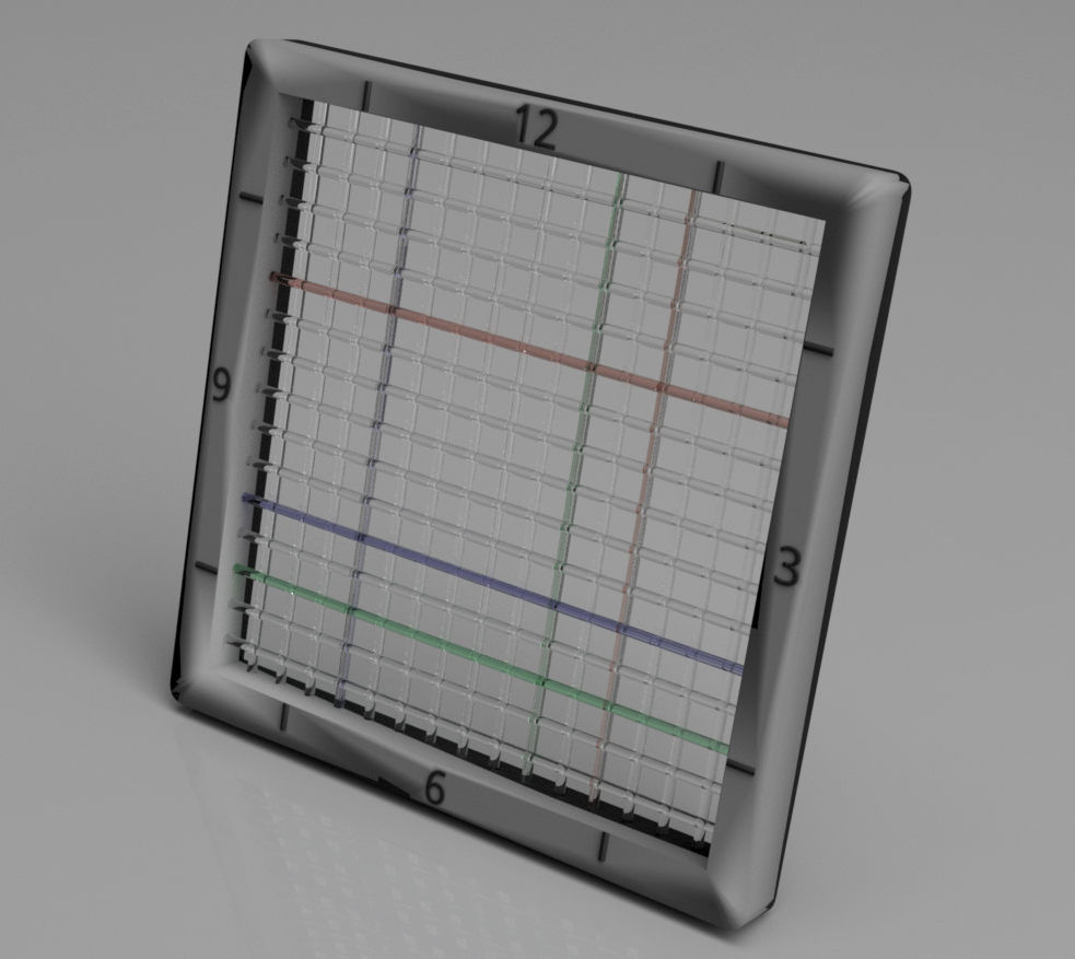

Also here I would mention that I thought about the possibility of using a LEDstrip of 90 LEDs/m and to put in bodies 15 fibers vertically and 15 horizontally so as to make a… WATCH! 🙂 It would be kind of like in the rendering below.
The idea would be that the intersection of the 2 optical fibers lit in red be the hours, green the minutes and blue the seconds. But I'm still in the design phase...
Anyway, you should know that it tempts me (I already have the strip of 90 LEDs/meter 🙂).
