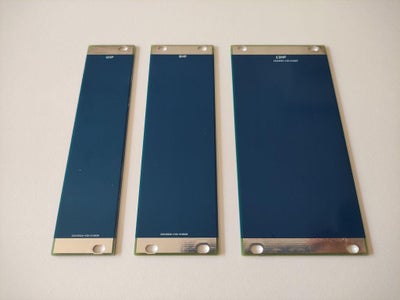

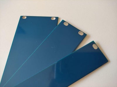

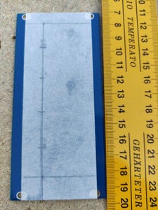

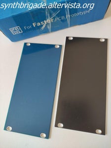

Fiberglass panels I have layed out for my own use are very simple. They are almost plain, 3U panels with elongated mounting holes and exposed copper on the backside to guarantee an electrical connection with racks metallic rails.
I layed out four panles for now: 4HP, 6HP, 8HP and 12HP, but PCB layout dedicated softwares make the realization of any other dimension fast and painless once you get used to it (EDIT: 16HP panels files are now available!).
In the attached picture, the measures for the 6HP PCB (for your reference). Holes (vias actually) are 3.6 mm in diameter. I used a trick to ovalize vias: I placed more than one "regular", circular vias, side by side with a spacing of 0.5 mm. There are cleaner methods to obtain the same reasult (i.e. by toying with pads), but this is simple and worked like a charm.

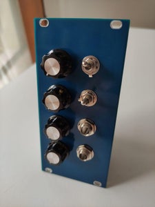

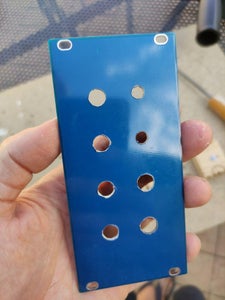

I have candidate these panels for both these pourposes, so I have had the opportunity to drill some hole in them and place my custom made modules.
From a workability point of view, I think that attached images speak for themself: you can drill precisely dimensioned holes to accomodate your modules, without running the risk to crack or break the PCB in the process.
Consider that I only have a cheap hand-drill (not a columnar drill or other specific gear) and a wood panel with some log to keep everithing securely in place, so my equipment is barebone. I also have very limited manuality (I prefer to spend time on writing codes and layout PCBs), so if I can do it, you can do it :)
So, are these suitable for the use in our synthesizers?
Well, provided you don't go too low in panel width, my impression is that (up to 3U in height) 1.6 mm thick fiberglass panels actually are, and all my modules will be accomodate in fiberglass panels. Reinforced fiberglass is not aluminum, obviously, but for my experience it is a very good candidate for the application.

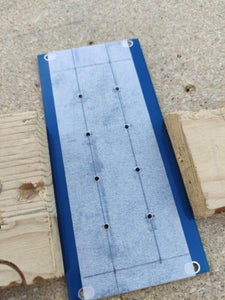

    1. Start by tracing your layout on adhesive paper. Noting the diameter of the hole near where it will be drilled will help to avoid errors in case of multiple, different panels ;)
    2. Drill a small hole with a very small drill bit (1.5 - 2 mm). Be careful because the position of this hole will determine the center position of your final hole. This drill acts as a guide for the following bits and help you enormously keeping the final hole well placed.
    3. Widen the guide hole step-by-step by using drill bits larger ad larger. I suggest to start with 2 mm steps, but you probably should use 1 mm steps when widening holes with diameter higher than 7-8 mm and especially when approaching the final hole diameter.
    4. When you have all your holes drilled, use a small, round file to remove copper chips on holes borders.Notice that this phase will increase a little the hole diameter.
    5. Clean the PCB with soap and water.
    Keep in mind that chips coming from the PCB can be conductive because of copper layers on both surfaces. To avoid shorts and damage to your modules it's important to get rid of those chips carefully.
    I had to go up to 8 mm drill diameter for potentiometers, 9.5 mm for 6.3 mm female jacks and 6 mm for latching switches (see picture).

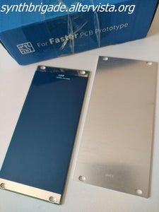

    Step 6: Pre-Drilled Aluminum Front Panels Anyone?
    Aluminum is the standard material when dealing with modules for synthesizers. If you have adeguate tools (or adeguate friends :D) you can machine them with no problems, but what if you have not?
    Well, after reading this instructables the answer is obvious - "fiberglass blank panels": easy to drill, sturdy enought and cheap.
    But what if you still want aluminum?

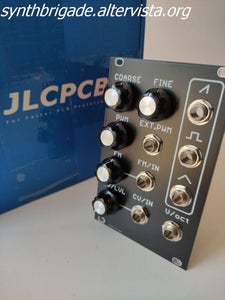

    Aluminum PCBs are an option for some time now. Having aluminum blank panels machined by PCBs manufacturers is something we, synthesizers enthusiast, can take advantage from and likely a new sector of business for PCB manufacturers.
    I asked JLCPCB to realize some 1.6 mm thick front panels to take a look at them and see if those are actually adeguate for our use... bet it, they are!
    I had a 3340 VCO panel realized starting from gerber files I layed down, but also some 12HP panels. In the pictures attached to this step you can see them.
