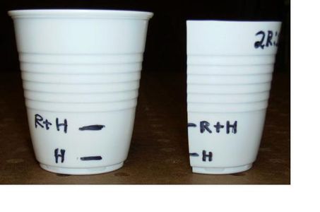

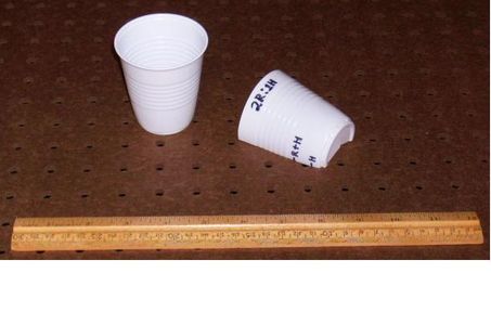

I found a way to mix small batches of epoxy resin and its hardener, in proper proportions, even if the liquids are in large containers. A little effort in advance will make the job easier. Mixing epoxy in graduated containers is costly, and measuring the liquids in a graduated container then pouring together into a small mixing cup can lead to inexact proportions. First, get sleeves of a few sizes of clear or translucent plastic or paper cups (not waxed!) that will hold the different amounts of mixed material you think you might need, with enough room free at the top of the cup to allow for stirring. Using the following notes, make a reusable "calibration half-cup" for each size cup and for each size batch within that cup size.
Note the half-cup has its upper rim cut off so it will nest perfectly onto the side of a new cup. It is marked "2R:1H," to denote that this half-cup is to be used with epoxies that call for a ratio of "2 parts Resin to 1 part Hardener."

Step 3: Make and Calibrate the Half-cup
Photo shows how "calibrated half-cup" is put onto the side of a cup that will be used for mixing a small batch, and the calibration marks transferred to the new cup.
For each cup size, take a new cup and put WATER into it that is about one-third the amount of the final batch of mixed epoxy, and make a mark at that level on the outside of the cup. Pour all that water into a clean cup and mark its level on the outside and label that mark as "H" for hardener. Put water into the first cup again, to its marked level, pour that water into the second cup on top of the water already in it, then repeat. Mark the top of the water level on the outside of the second cup and label it "R+H" for resin plus hardener.
Repeat the procedure if you want to calibrate the second cup for a larger epoxy batch in that same cup size, putting the level marks on the opposite size of the cup. Cut the calibration cup in half vertically, and keep it with your stash of that size cup.

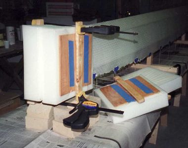

Vaccuum bagging is great for clamping fiberglass tightly over a shape and removing air bubbles, but it is too complicated and costly a procedure for occasional use. For smashing wetted cloth tight to the sharp bow of a hull, I made clamps by backing up foot-square blocks of 4-inch thick foam rubber with squares of 3/8-inch thick plywood and wooden sticks. Before use, I wrap plastic wrap around each foam clamp and tape it to the wood backside. Two slide clamps squeeze the cloth and conform it to the hull mold's shape. Rubber foam can be cleanly cut using straight edge guides and a hotwire cutter. Click on link to see album "Cutting Rigid Plastic Foam," click on "READ FIRST" instructions for reading and printing fine text. http://www.flickr.com/photos/sm_vermn/tags/foamcutter

Wet fiberglass cloth can be made to wrap over a sharp edge, but it will lift up off the edge before the epoxy sets unless it is clamped in place. Here is the full-body version of the foam block clamp. I used a sheet of white upholstery foam, 1-inch thick, to press the wet cloth around the bottom of the hull (facing up in this photo). I pre-cut strips of a stretchy 5-inch wide colored foam, sold in rolls at home centers as a barrier between the top of a house's foundation and the house itself, marked each strip in sequence. Once the fiberglass was wetted out, I smoothed a precut strip of thin clear plastic tarp over the wet fabric as a mold release, placed the white foam sheet over that, then stretched each strip of the colored foam and taped its ends together with duct tape.
