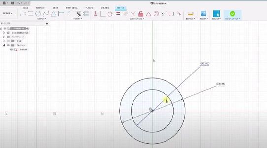

Step 1: Circles
At first, we will start by making 2 circles inside one other at the size of 22 and 34.

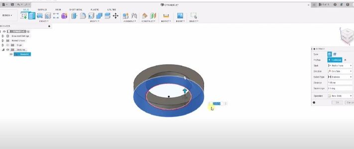

Step 2: Making the Circles 3d
Now we will pull the circles apart to give them a 3d cylindrical shape so they can be a part of our fidget spinner.

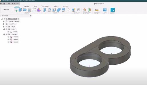

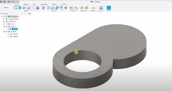

Step 6: Cutting a Hole
Now we will draw a circle shape on our flower and crop it apart to give it more of a goggle shape.
Step 7: 3 Times
So after we have our hole cropped, we will repeat the step 2 more time to give it the outer fidget spinner shape.

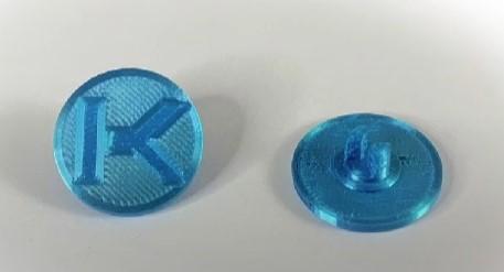

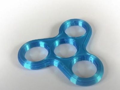

Step 10: 3d Printing
So after you are done with your designs, you can now start to 3d print them!

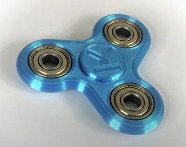

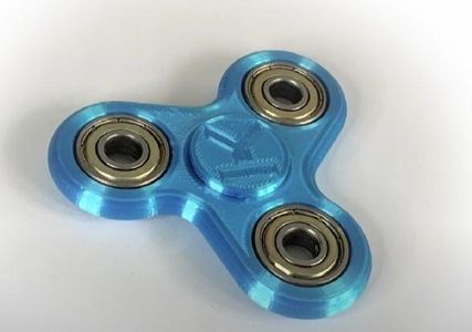

Step 11: Finally
Now finally, you can put your pieces together and play with your fidget spinner as long as you want !!! :)
